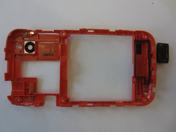

    • Use a Torx T5 screwdriver to unscrew and remove five 3.0 mm screws from the rear frame.
  4. HTC Desire V Speaker Replacement: crwdns2935265:04crwdnd2935265:01crwdnd2935265:03crwdne2935265:0 HTC Desire V Speaker Replacement: crwdns2935265:04crwdnd2935265:02crwdnd2935265:03crwdne2935265:0 HTC Desire V Speaker Replacement: crwdns2935265:04crwdnd2935265:03crwdnd2935265:03crwdne2935265:0
    • Use an opening tool or a spudger to gently remove the rear frame.

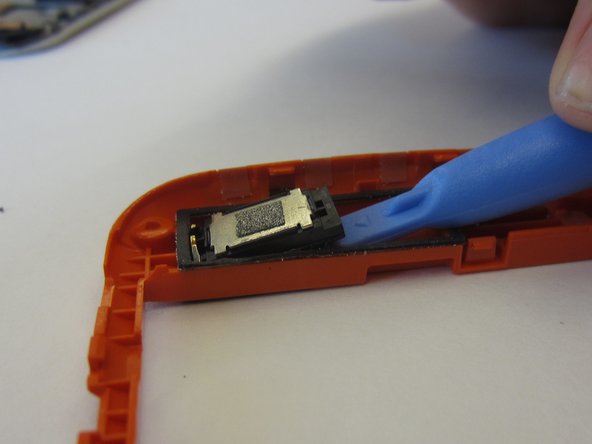

  5. HTC Desire V Speaker Replacement, Speaker: crwdns2935265:05crwdnd2935265:01crwdnd2935265:03crwdne2935265:0 HTC Desire V Speaker Replacement, Speaker: crwdns2935265:05crwdnd2935265:02crwdnd2935265:03crwdne2935265:0 HTC Desire V Speaker Replacement, Speaker: crwdns2935265:05crwdnd2935265:03crwdnd2935265:03crwdne2935265:0
    • Using a smaller prying tool, spudger or similar, lever up the speaker at the bottom end of the phone shown in the picture (bottom right)
    • The bottom is sticky, so expect some resistance
