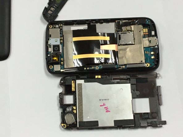

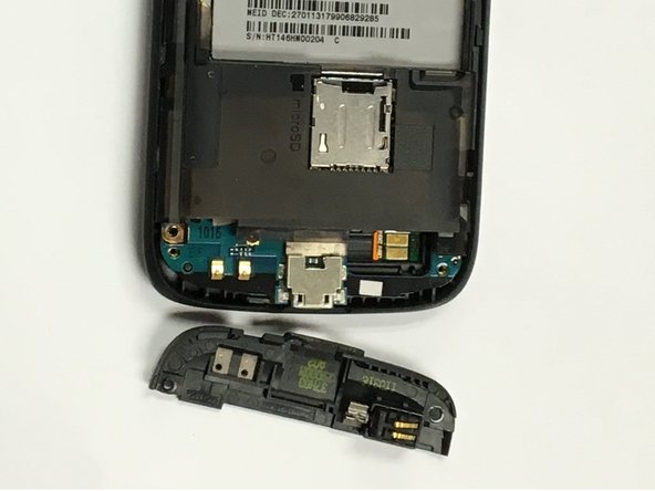

    • Insert flat end of spudger into slot on the top of phone to pry off the back plate.
  2. HTC Desire HTC Desire Speaker Replacement: crwdns2935265:02crwdnd2935265:01crwdnd2935265:02crwdne2935265:0 HTC Desire HTC Desire Speaker Replacement: crwdns2935265:02crwdnd2935265:02crwdnd2935265:02crwdne2935265:0
    • Use flat edge of spudger to lift the bottom right corner of the battery.
    • Lift the battery out of the phone.

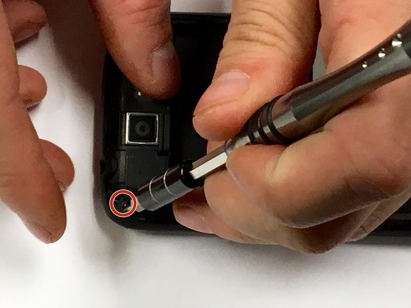

  3. HTC Desire HTC Desire Speaker Replacement, Vibrator: crwdns2935265:03crwdnd2935265:01crwdnd2935265:01crwdne2935265:0
    • Remove the lower, two 0.5 mm screws using Torx T5 screwdriver.

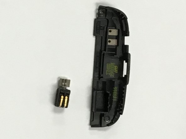

  4. HTC Desire HTC Desire Speaker Replacement: crwdns2935265:04crwdnd2935265:01crwdnd2935265:02crwdne2935265:0 HTC Desire HTC Desire Speaker Replacement: crwdns2935265:04crwdnd2935265:02crwdnd2935265:02crwdne2935265:0
    • Use spudger to pry vibrator panel off.
  5. HTC Desire HTC Desire Speaker Replacement: crwdns2935265:05crwdnd2935265:01crwdnd2935265:02crwdne2935265:0 HTC Desire HTC Desire Speaker Replacement: crwdns2935265:05crwdnd2935265:02crwdnd2935265:02crwdne2935265:0
    • Use spudger to remove the vibrator.
  6. HTC Desire HTC Desire Speaker Replacement, HTC Desire Speaker: crwdns2935265:06crwdnd2935265:01crwdnd2935265:02crwdne2935265:0 HTC Desire HTC Desire Speaker Replacement, HTC Desire Speaker: crwdns2935265:06crwdnd2935265:02crwdnd2935265:02crwdne2935265:0
    • Take out the upper, two 0.5 mm Torx screws with a Torx T5 bit.
  7. HTC Desire HTC Desire Speaker Replacement: crwdns2935265:07crwdnd2935265:01crwdnd2935265:01crwdne2935265:0
    • Take the middle 0.3 mm phillips screw out with the phillips J000 tip.

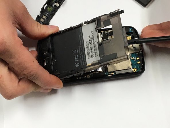

  8. HTC Desire HTC Desire Speaker Replacement: crwdns2935265:08crwdnd2935265:01crwdnd2935265:03crwdne2935265:0 HTC Desire HTC Desire Speaker Replacement: crwdns2935265:08crwdnd2935265:02crwdnd2935265:03crwdne2935265:0 HTC Desire HTC Desire Speaker Replacement: crwdns2935265:08crwdnd2935265:03crwdnd2935265:03crwdne2935265:0
    • Using the spudger, pry up to remove the battery holder.

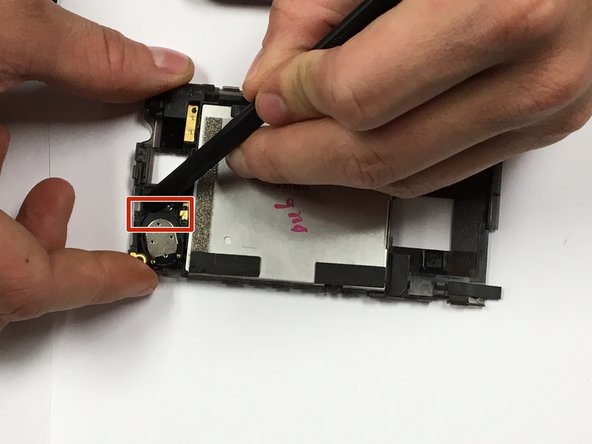

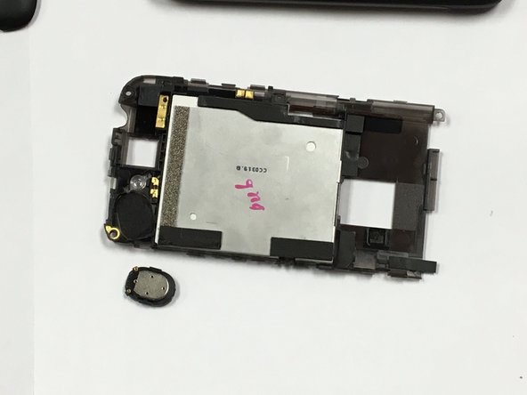

  9. HTC Desire HTC Desire Speaker Replacement: crwdns2935265:09crwdnd2935265:01crwdnd2935265:03crwdne2935265:0 HTC Desire HTC Desire Speaker Replacement: crwdns2935265:09crwdnd2935265:02crwdnd2935265:03crwdne2935265:0 HTC Desire HTC Desire Speaker Replacement: crwdns2935265:09crwdnd2935265:03crwdnd2935265:03crwdne2935265:0
    • Using the spudger, pry the speaker out of its place.
  10. HTC Desire HTC Desire Speaker Replacement: crwdns2935265:010crwdnd2935265:01crwdnd2935265:01crwdne2935265:0
    • With the springs up, place the new speaker into position.
