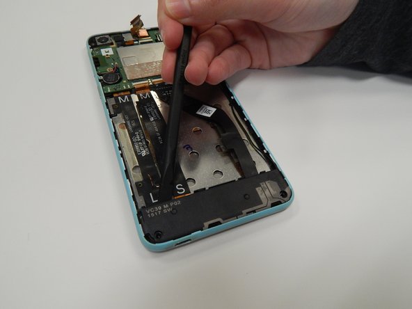

  6. HTC Desire 826 Screen Replacement: crwdns2935265:06crwdnd2935265:01crwdnd2935265:01crwdne2935265:0
    • Use tweezers to pry the wire up from the battery bed
    • Detach the ribbon cable by pulling with the tweezers where circled in blue
    • Flip the phone over so the screen side is facing up for the next step

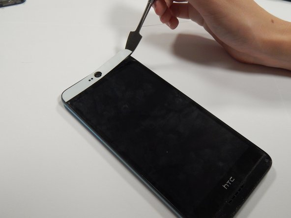

  7. HTC Desire 826 Screen Replacement: crwdns2935265:07crwdnd2935265:01crwdnd2935265:02crwdne2935265:0 HTC Desire 826 Screen Replacement: crwdns2935265:07crwdnd2935265:02crwdnd2935265:02crwdne2935265:0
    • Use the metal spudger to pry up the plastic cover pieces from the front of the phone

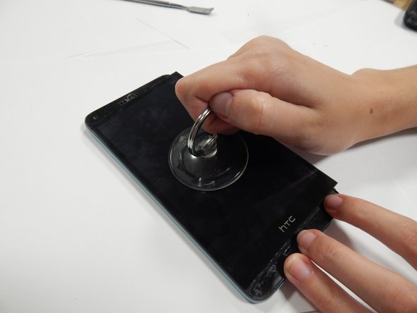

  8. HTC Desire 826 Screen Replacement: crwdns2935265:08crwdnd2935265:01crwdnd2935265:02crwdne2935265:0 HTC Desire 826 Screen Replacement: crwdns2935265:08crwdnd2935265:02crwdnd2935265:02crwdne2935265:0
    • Pry up the edges of the screen using the metal spudger
    • Then use the suction cup to remove the screen from your device
    • There will likely be glue holding your screen in place, so keep prying but be cautious not to break the screen. You may want to use the iOpener to loosen the adhesive prior to removal.
