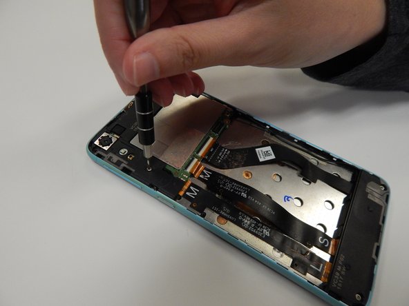

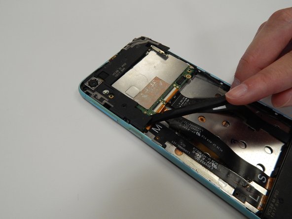

    • Use the T5 screwdriver to remove the three 4.00 mm screws as shown.
    • Once the screws are removed, pry up the top plastic panel using the black nylon spudger.

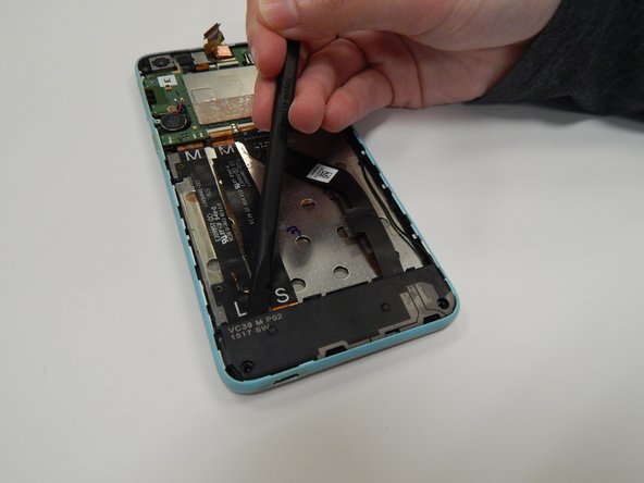

    • Unscrew the two 4.00 mm screws attaching the bottom plastic panel using a T5 screwdriver.
    • Using the spudger, remove the bottom plastic piece.

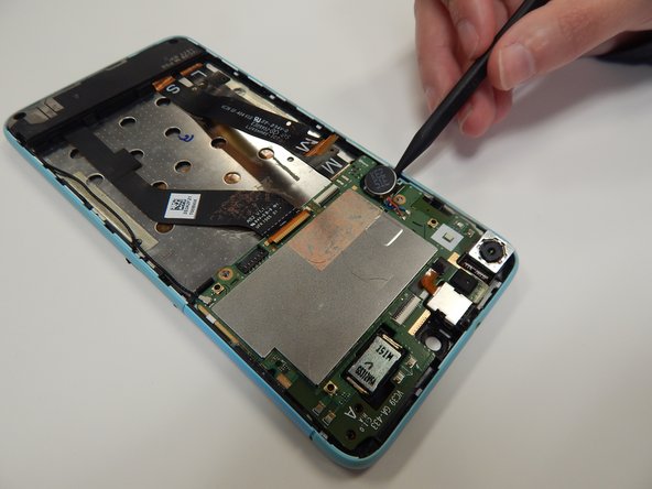

    • Using the spudger, remove the bottom part of the motherboard.

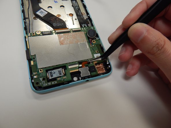

    • Using the angled tweezers, disconnect the headphone jack from the motherboard.
    • Using the plastic spudger, pop out the circular silver piece and lift the top part of the motherboard.

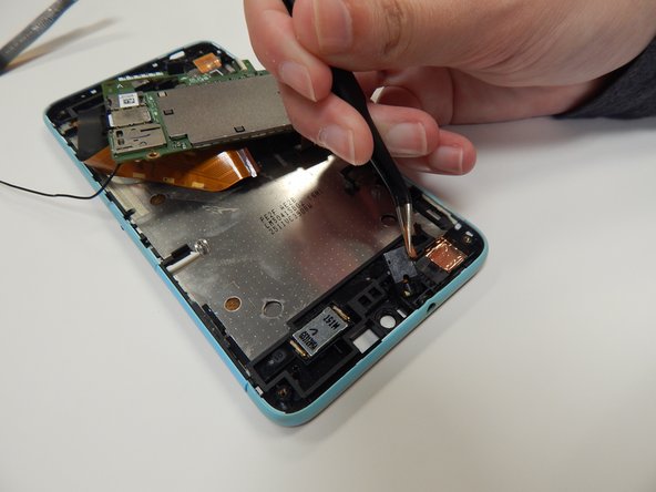

    • Using the angled tweezers, pop off the metal piece on top of the headphone jack.
    • Using the angled tweezers, remove the headphone jack.
