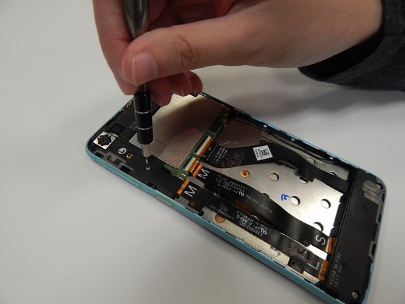

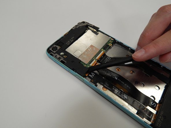

  5. HTC Desire 826 Front Camera Replacement, Front Camera: crwdns2935265:05crwdnd2935265:01crwdnd2935265:03crwdne2935265:0 HTC Desire 826 Front Camera Replacement, Front Camera: crwdns2935265:05crwdnd2935265:02crwdnd2935265:03crwdne2935265:0 HTC Desire 826 Front Camera Replacement, Front Camera: crwdns2935265:05crwdnd2935265:03crwdnd2935265:03crwdne2935265:0
    • Use the T5 screwdriver to remove the three 4.0 mm screws as shown.
    • Once the screws are removed, pry up the top plastic panel using the black nylon spudger.

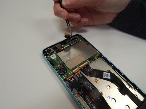

  6. HTC Desire 826 Front Camera Replacement: crwdns2935265:06crwdnd2935265:01crwdnd2935265:02crwdne2935265:0 HTC Desire 826 Front Camera Replacement: crwdns2935265:06crwdnd2935265:02crwdnd2935265:02crwdne2935265:0
    • Use the tweezers to detach the cameras wire from the top motherboard
    • Then use the tweezers to remove the camera
