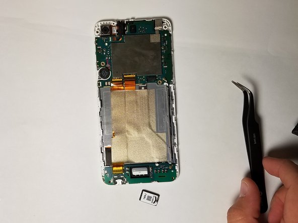

  4. HTC Desire 626s Loud Speaker Replacement, Loud Speaker: crwdns2935265:04crwdnd2935265:01crwdnd2935265:01crwdne2935265:0
    • Use tweezers to lift the speaker straight up.
    • You can locate the loudspeaker at the base of the phone; it should have a white sticker on it.
  5. HTC Desire 626s Loud Speaker Replacement: crwdns2935265:05crwdnd2935265:01crwdnd2935265:02crwdne2935265:0 HTC Desire 626s Loud Speaker Replacement: crwdns2935265:05crwdnd2935265:02crwdnd2935265:02crwdne2935265:0
    • Wiggle the loudspeaker with the tweezers if it does not at first come out.
    • Congratulations you have successfully removed the loudspeaker.
