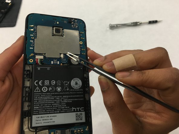

  6. HTC Desire 610 Vibration Motor Replacement, Vibration Motor: crwdns2935265:06crwdnd2935265:01crwdnd2935265:02crwdne2935265:0 HTC Desire 610 Vibration Motor Replacement, Vibration Motor: crwdns2935265:06crwdnd2935265:02crwdnd2935265:02crwdne2935265:0
    • Pull the wire harness from the circuit board that is connected to the vibration motor using a pair of precision tweezers.
    • Be careful! Damaging this port could prevent a new vibration motor from functioning.
  7. HTC Desire 610 Vibration Motor Replacement: crwdns2935265:07crwdnd2935265:01crwdnd2935265:02crwdne2935265:0 HTC Desire 610 Vibration Motor Replacement: crwdns2935265:07crwdnd2935265:02crwdnd2935265:02crwdne2935265:0
    • Pry the vibration motor from it's housing using precision tweezers.
    • The vibration motor is held in place with adhesive, so you may need to pry a little harder to remove it.
