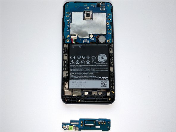

    • Using plastic opening tool, take off the back cover of the phone.
  3. HTC Desire 610 Daughterboard Replacement: crwdns2935265:03crwdnd2935265:01crwdnd2935265:01crwdne2935265:0
    • Using Phillips #000 Screwdriver, remove the two 2.5mm phillips head screws.
  4. HTC Desire 610 Daughterboard Replacement: crwdns2935265:04crwdnd2935265:01crwdnd2935265:01crwdne2935265:0
    • Using Torx T5 Screwdriver, remove the four 5mm silver torx head screws.
  5. HTC Desire 610 Daughterboard Replacement: crwdns2935265:05crwdnd2935265:01crwdnd2935265:01crwdne2935265:0
    • Using Torx T5 Screwdriver, remove the four 4mm black torx screws
  6. HTC Desire 610 Daughterboard Replacement: crwdns2935265:06crwdnd2935265:01crwdnd2935265:02crwdne2935265:0 HTC Desire 610 Daughterboard Replacement: crwdns2935265:06crwdnd2935265:02crwdnd2935265:02crwdne2935265:0
    • Using plastic opening tool, remove the black plastic circuit cover.
  7. HTC Desire 610 Daughterboard Replacement: crwdns2935265:07crwdnd2935265:01crwdnd2935265:01crwdne2935265:0
    • Using Torx T5 Screwdriver, remove the 4mm black torx screw.
  8. HTC Desire 610 Daughterboard Replacement: crwdns2935265:08crwdnd2935265:01crwdnd2935265:02crwdne2935265:0 HTC Desire 610 Daughterboard Replacement: crwdns2935265:08crwdnd2935265:02crwdnd2935265:02crwdne2935265:0
    • Using Tweezers, disconnect antenna wire.
  9. HTC Desire 610 Daughterboard Replacement: crwdns2935265:09crwdnd2935265:01crwdnd2935265:03crwdne2935265:0 HTC Desire 610 Daughterboard Replacement: crwdns2935265:09crwdnd2935265:02crwdnd2935265:03crwdne2935265:0 HTC Desire 610 Daughterboard Replacement: crwdns2935265:09crwdnd2935265:03crwdnd2935265:03crwdne2935265:0
    • Using Tweezers, remove loud speaker that is being held by small adhesive.
    • When putting loud speaker back on, the prongs sticking up should be on the side closer to the top of the phone.
  10. HTC Desire 610 Daughterboard Replacement: crwdns2935265:010crwdnd2935265:01crwdnd2935265:02crwdne2935265:0 HTC Desire 610 Daughterboard Replacement: crwdns2935265:010crwdnd2935265:02crwdnd2935265:02crwdne2935265:0
    • Using Tweezers, peel back gray adhesive.
  11. HTC Desire 610 Daughterboard Replacement: crwdns2935265:011crwdnd2935265:01crwdnd2935265:02crwdne2935265:0 HTC Desire 610 Daughterboard Replacement: crwdns2935265:011crwdnd2935265:02crwdnd2935265:02crwdne2935265:0
    • Using Tweezers, flip the white strip upward so it sits 90°.

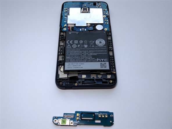

  12. HTC Desire 610 Daughterboard Replacement: crwdns2935265:012crwdnd2935265:01crwdnd2935265:03crwdne2935265:0 HTC Desire 610 Daughterboard Replacement: crwdns2935265:012crwdnd2935265:02crwdnd2935265:03crwdne2935265:0 HTC Desire 610 Daughterboard Replacement: crwdns2935265:012crwdnd2935265:03crwdnd2935265:03crwdne2935265:0
    • Using plastic opening tool, pry up green plate and pull outward.
    • Daughterboard is off. Get new daughterboard and reverse steps.
