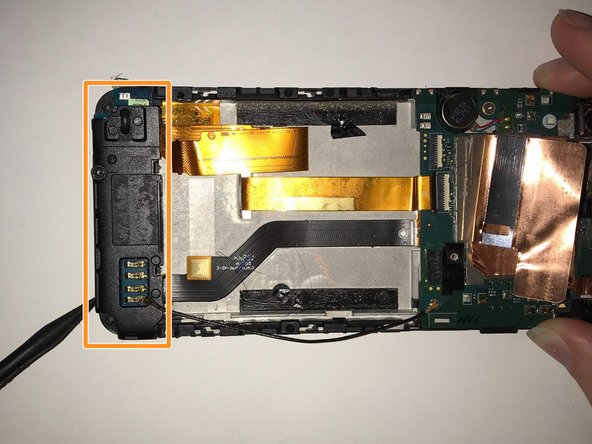

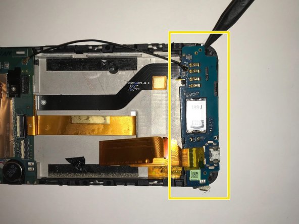

  5. HTC Desire 530 Speaker Replacement, Speaker: crwdns2935265:05crwdnd2935265:01crwdnd2935265:03crwdne2935265:0 HTC Desire 530 Speaker Replacement, Speaker: crwdns2935265:05crwdnd2935265:02crwdnd2935265:03crwdne2935265:0 HTC Desire 530 Speaker Replacement, Speaker: crwdns2935265:05crwdnd2935265:03crwdnd2935265:03crwdne2935265:0
    • Use the T5 Torx screwdriver to remove the screw located on the left side.
    • Use the spudger to slowly pry off the black cover.
    • Slowly pry off the circuit board with the spudger in a very cautious manner.

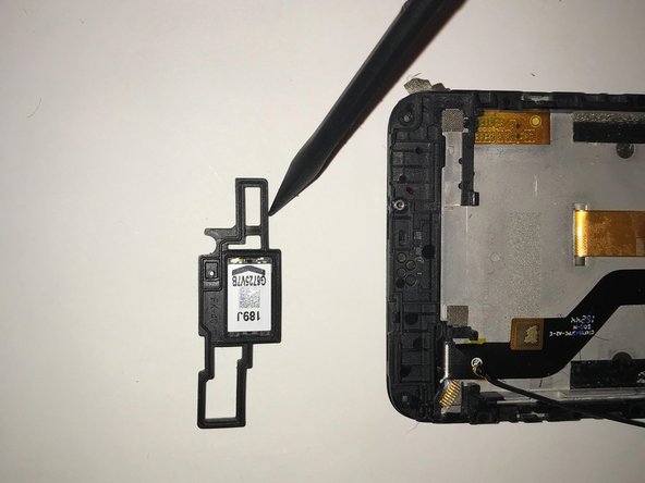

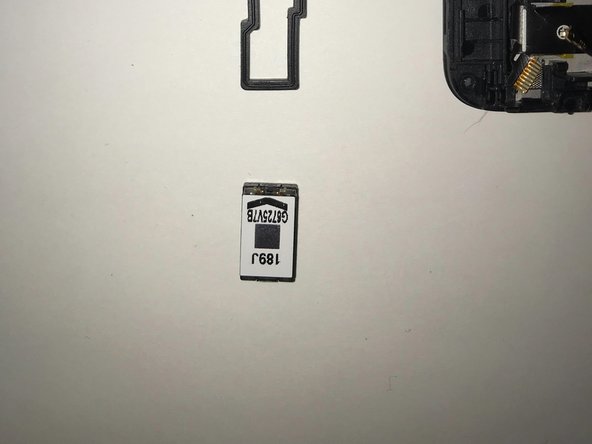

  6. HTC Desire 530 Speaker Replacement: crwdns2935265:06crwdnd2935265:01crwdnd2935265:03crwdne2935265:0 HTC Desire 530 Speaker Replacement: crwdns2935265:06crwdnd2935265:02crwdnd2935265:03crwdne2935265:0 HTC Desire 530 Speaker Replacement: crwdns2935265:06crwdnd2935265:03crwdnd2935265:03crwdne2935265:0
    • Remove the rubber object by pinching and pulling it out.
    • Take the speaker out of the holder.

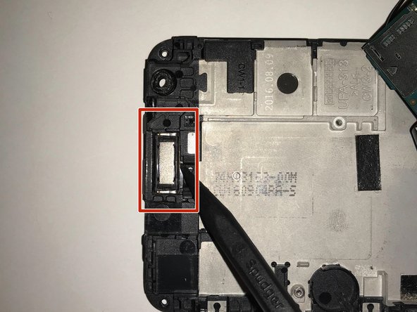

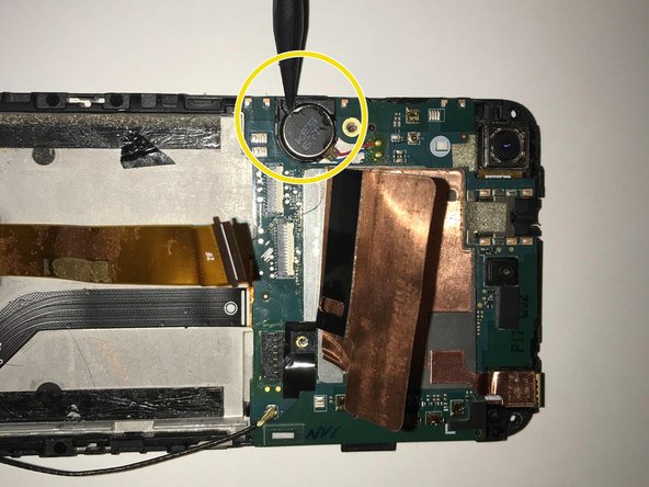

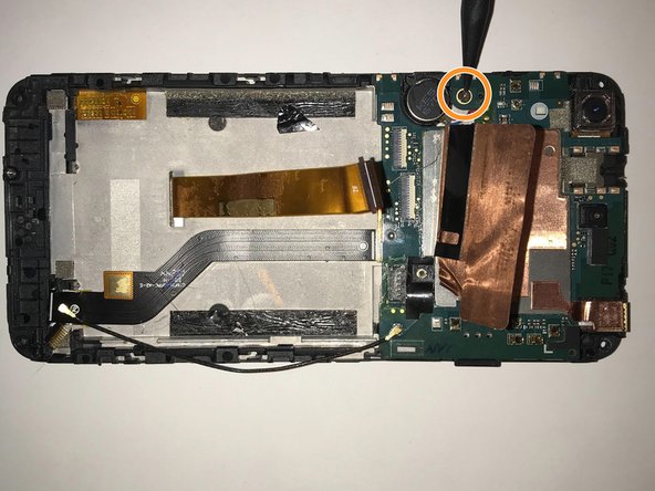

  7. HTC Desire 530 Speaker Replacement: crwdns2935265:07crwdnd2935265:01crwdnd2935265:03crwdne2935265:0 HTC Desire 530 Speaker Replacement: crwdns2935265:07crwdnd2935265:02crwdnd2935265:03crwdne2935265:0 HTC Desire 530 Speaker Replacement: crwdns2935265:07crwdnd2935265:03crwdnd2935265:03crwdne2935265:0
    • To access the top speaker, you must first detach the orange cable from its holder with your fingers.
    • Remove the T5 Torx screw.
    • Carefully pry off the circular object with the spudger.
    • Do not accidentally disconnect this object from the phone. It is connected by 2 short wires.

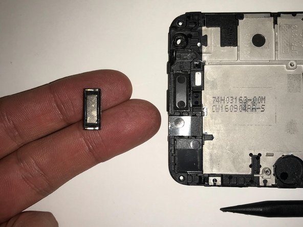

  8. HTC Desire 530 Speaker Replacement: crwdns2935265:08crwdnd2935265:01crwdnd2935265:03crwdne2935265:0 HTC Desire 530 Speaker Replacement: crwdns2935265:08crwdnd2935265:02crwdnd2935265:03crwdne2935265:0 HTC Desire 530 Speaker Replacement: crwdns2935265:08crwdnd2935265:03crwdnd2935265:03crwdne2935265:0
    • Use the spudger to carefully work your way around the edge of the motherboard and slowly pry it off.
    • Use the spudger to pry off the speaker.
