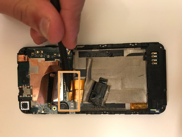

    • After the battery has been removed, there are two screws that also need to be removed
    • There are two gold strips that you must disconnect from the motherboard, They simply pop right off.

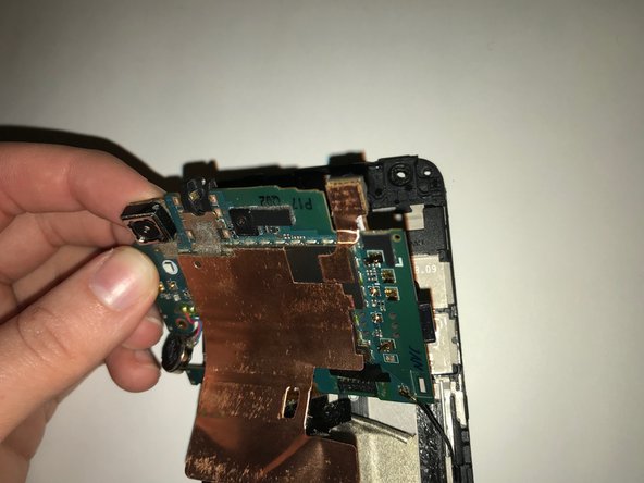

    • Remove the circular piece from the motherboard.
    • Proceed to pry off the motherboard. Go around all edges with the plastic opening tool and it should come off with ease.

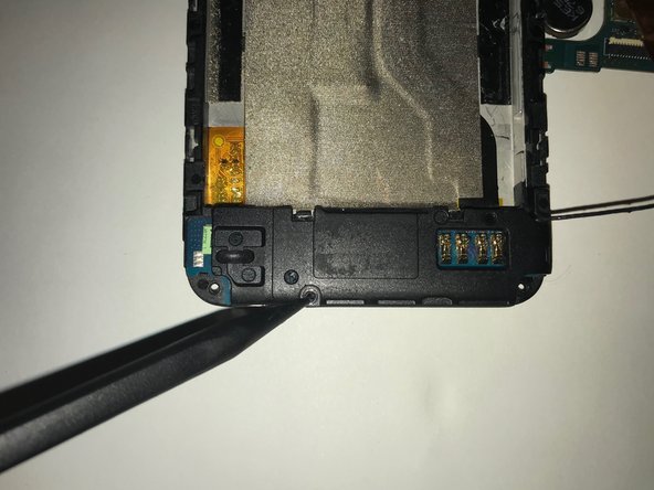

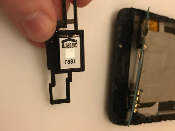

    • Next, the motherboard should still be connected by a wire that leads to the bottom portion of the phone.
    • To remove the black plastic piece there is one screw that needs to be removed then you can pry it off with the plastic opening tool.

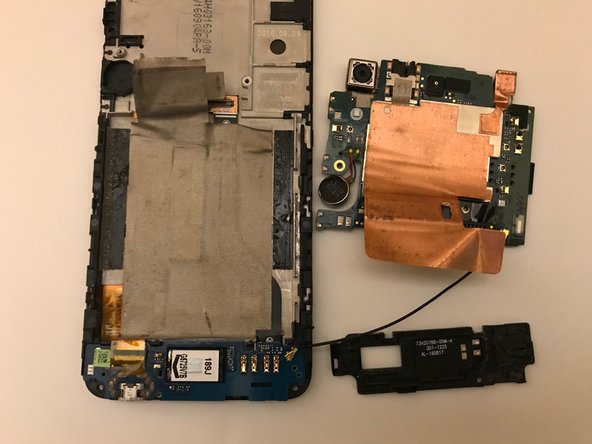

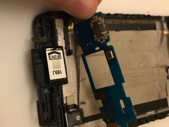

    • To fully remove the motherboard the last step is to disconnect the wire that was previously mentioned.
    • Remove the motherboard.
    • Removal of wire from daughterboard is optional.

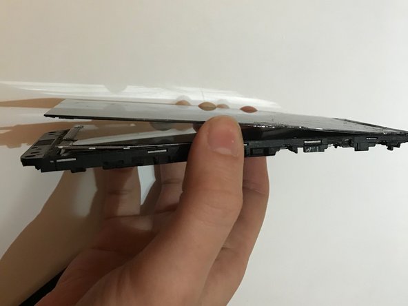

  9. HTC Desire 530 Screen Replacement: crwdns2935265:09crwdnd2935265:01crwdnd2935265:03crwdne2935265:0 HTC Desire 530 Screen Replacement: crwdns2935265:09crwdnd2935265:02crwdnd2935265:03crwdne2935265:0 HTC Desire 530 Screen Replacement: crwdns2935265:09crwdnd2935265:03crwdnd2935265:03crwdne2935265:0
    • After the phone is gutted, all that is left is to pry the actual screen off from the backing and prepare for replacement.
