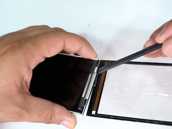

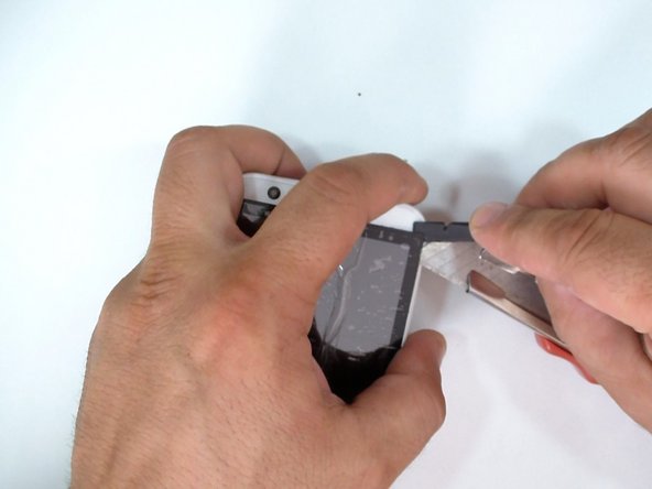

  6. HTC Desire 510 Touch screen Glass and/or LCD Display, SEPARATION THE GLASS: crwdns2935265:06crwdnd2935265:01crwdnd2935265:03crwdne2935265:0 HTC Desire 510 Touch screen Glass and/or LCD Display, SEPARATION THE GLASS: crwdns2935265:06crwdnd2935265:02crwdnd2935265:03crwdne2935265:0 HTC Desire 510 Touch screen Glass and/or LCD Display, SEPARATION THE GLASS: crwdns2935265:06crwdnd2935265:03crwdnd2935265:03crwdne2935265:0
    • Use a cutter and slightly lift the glass in one of the corners. When you make enough room, put a plastic tool.
    • Continue the separating with plastic tools to prevent the middle frame from scratches.

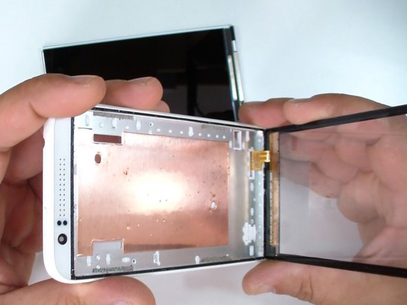

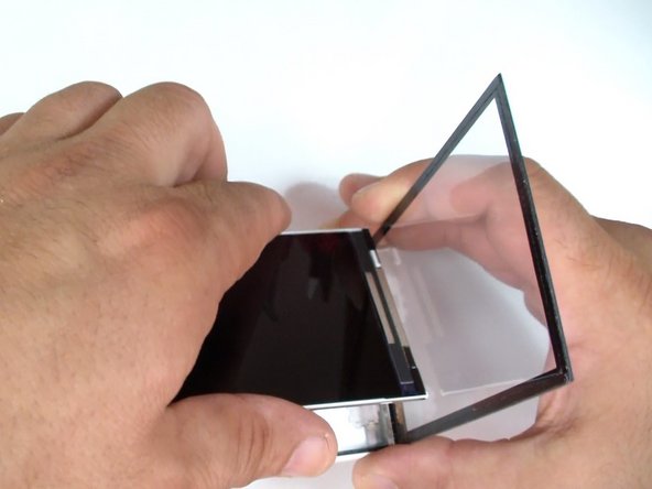

  7. HTC Desire 510 Touch screen Glass and/or LCD Display, SEPARATION THE GLASS (2): crwdns2935265:07crwdnd2935265:01crwdnd2935265:03crwdne2935265:0 HTC Desire 510 Touch screen Glass and/or LCD Display, SEPARATION THE GLASS (2): crwdns2935265:07crwdnd2935265:02crwdnd2935265:03crwdne2935265:0 HTC Desire 510 Touch screen Glass and/or LCD Display, SEPARATION THE GLASS (2): crwdns2935265:07crwdnd2935265:03crwdnd2935265:03crwdne2935265:0
    • The digitizer flex cable goes under the LCD display.
    • Slightly lift the display and unstuck the digitizer ribbon cable from the from the rear side of the display.

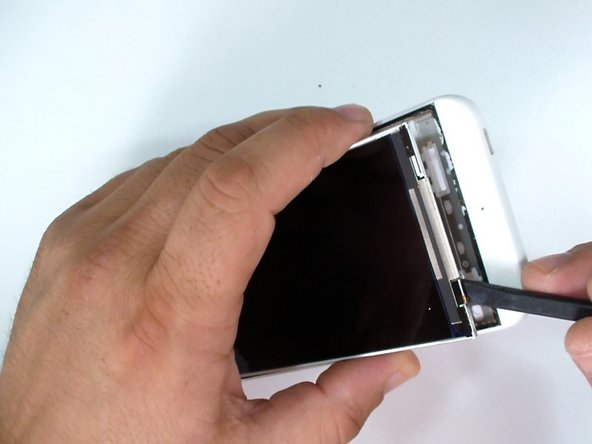

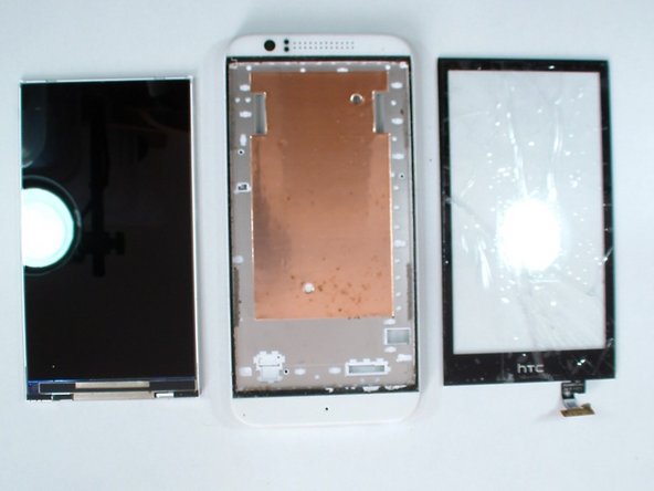

  8. HTC Desire 510 Touch screen Glass and/or LCD Display, LCD DISPLAY: crwdns2935265:08crwdnd2935265:01crwdnd2935265:03crwdne2935265:0 HTC Desire 510 Touch screen Glass and/or LCD Display, LCD DISPLAY: crwdns2935265:08crwdnd2935265:02crwdnd2935265:03crwdne2935265:0 HTC Desire 510 Touch screen Glass and/or LCD Display, LCD DISPLAY: crwdns2935265:08crwdnd2935265:03crwdnd2935265:03crwdne2935265:0
    • If you have a broken LCD display, use a plastic tool and remove it from the middle frame.
    • It's not glued to the frame.
  9. HTC Desire 510 Touch screen Glass and/or LCD Display, INSTALLING THE NEW SPARE PART: crwdns2935265:09crwdnd2935265:01crwdnd2935265:03crwdne2935265:0 HTC Desire 510 Touch screen Glass and/or LCD Display, INSTALLING THE NEW SPARE PART: crwdns2935265:09crwdnd2935265:02crwdnd2935265:03crwdne2935265:0 HTC Desire 510 Touch screen Glass and/or LCD Display, INSTALLING THE NEW SPARE PART: crwdns2935265:09crwdnd2935265:03crwdnd2935265:03crwdne2935265:0
    • Install a new adhesive tape on the digitizer glass.
    • First put the touch screen flex cable in the right hole and then install the LCD Display.

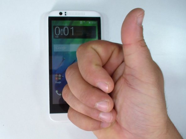

  10. HTC Desire 510 Touch screen Glass and/or LCD Display, REASSEMBLING: crwdns2935265:010crwdnd2935265:01crwdnd2935265:02crwdne2935265:0 HTC Desire 510 Touch screen Glass and/or LCD Display, REASSEMBLING: crwdns2935265:010crwdnd2935265:02crwdnd2935265:02crwdne2935265:0
    • Now is time to reassemble the phone.
    • That's all.
    • Did you do it successfully?
