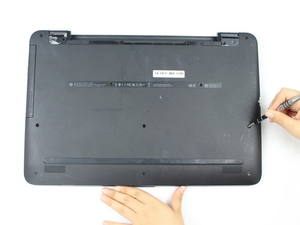

  4. HP17-x116dx Fan Replacement, Fan: crwdns2935265:04crwdnd2935265:01crwdnd2935265:02crwdne2935265:0 HP17-x116dx Fan Replacement, Fan: crwdns2935265:04crwdnd2935265:02crwdnd2935265:02crwdne2935265:0
    • Remove the fourteen 8 mm screws with the Phillips #1 screwdriver.
  5. HP17-x116dx Fan Replacement: crwdns2935265:05crwdnd2935265:01crwdnd2935265:02crwdne2935265:0 HP17-x116dx Fan Replacement: crwdns2935265:05crwdnd2935265:02crwdnd2935265:02crwdne2935265:0

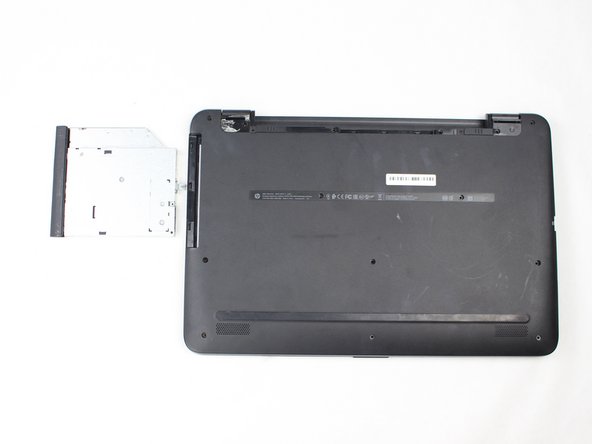

    • Once the screws are removed, carefully remove the CD player port.

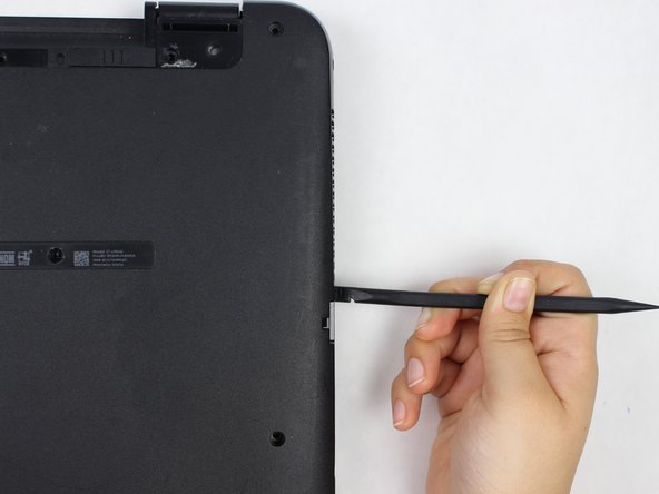

  6. HP17-x116dx Fan Replacement: crwdns2935265:06crwdnd2935265:01crwdnd2935265:02crwdne2935265:0 HP17-x116dx Fan Replacement: crwdns2935265:06crwdnd2935265:02crwdnd2935265:02crwdne2935265:0
    • Once you have removed the CD player port, use the spudger tool to carefully remove the back panel.

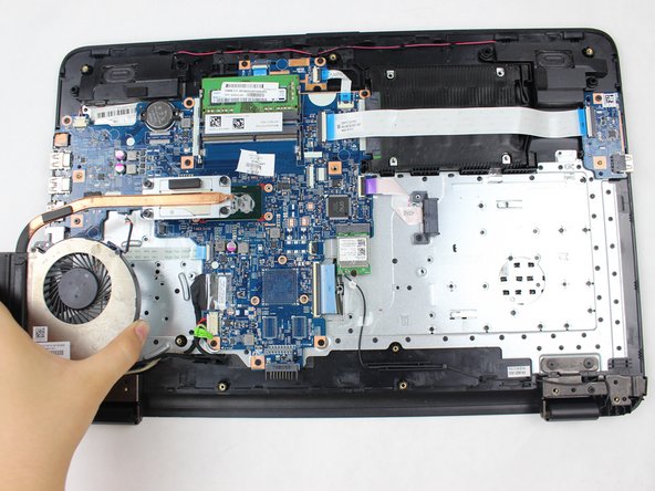

  7. HP17-x116dx Fan Replacement: crwdns2935265:07crwdnd2935265:01crwdnd2935265:01crwdne2935265:0
    • Once you remove the back panel you will see your fan on the bottom left side of your laptop.

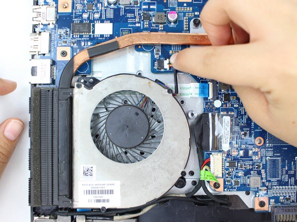

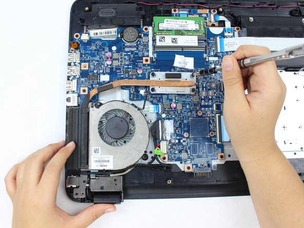

  8. HP17-x116dx Fan Replacement: crwdns2935265:08crwdnd2935265:01crwdnd2935265:03crwdne2935265:0 HP17-x116dx Fan Replacement: crwdns2935265:08crwdnd2935265:02crwdnd2935265:03crwdne2935265:0 HP17-x116dx Fan Replacement: crwdns2935265:08crwdnd2935265:03crwdnd2935265:03crwdne2935265:0
    • To remove the fan, start by unplugging the fan from the motherboard.
  9. HP17-x116dx Fan Replacement: crwdns2935265:09crwdnd2935265:01crwdnd2935265:03crwdne2935265:0 HP17-x116dx Fan Replacement: crwdns2935265:09crwdnd2935265:02crwdnd2935265:03crwdne2935265:0 HP17-x116dx Fan Replacement: crwdns2935265:09crwdnd2935265:03crwdnd2935265:03crwdne2935265:0
    • Once the fan is unplugged from the motherboard, remove the 6 mm screws with a Phillips #1 screwdriver that are connecting the fan to the laptop. Remove the fan.

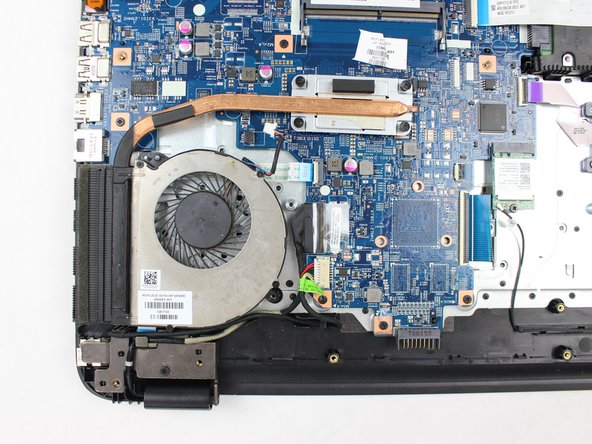

  10. HP17-x116dx Fan Replacement: crwdns2935265:010crwdnd2935265:01crwdnd2935265:01crwdne2935265:0
    • Once the fan is removed, you will see the hot plate that transfers the heat from the laptop to the fan. You will need to add thermal paste to the hot plate before placing your replacement fan back on.
