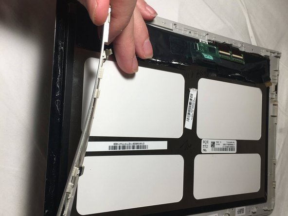

    • Pull the screen away from the keyboard.
  2. HP x2 10-p010wm Screen Replacement: crwdns2935265:02crwdnd2935265:01crwdnd2935265:02crwdne2935265:0 HP x2 10-p010wm Screen Replacement: crwdns2935265:02crwdnd2935265:02crwdnd2935265:02crwdne2935265:0
    • Insert a spudger into the space between the screen and computer and gently pry the two pieces apart. Continue this around the whole screen.
  3. HP x2 10-p010wm Screen Replacement: crwdns2935265:03crwdnd2935265:01crwdnd2935265:01crwdne2935265:0
    • Slowly disconnect the thin wire attaching the screen to the rest of the computer by holding one end and sliding it down.
    • Do not pull up too hard; slowly slide it towards the screen.

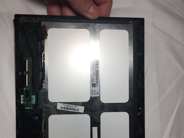

  4. HP x2 10-p010wm Screen Replacement: crwdns2935265:04crwdnd2935265:01crwdnd2935265:03crwdne2935265:0 HP x2 10-p010wm Screen Replacement: crwdns2935265:04crwdnd2935265:02crwdnd2935265:03crwdne2935265:0 HP x2 10-p010wm Screen Replacement: crwdns2935265:04crwdnd2935265:03crwdnd2935265:03crwdne2935265:0
    • Hold the screen with your thumb and push back on the plastic frame.
    • Slowly separate the plastic frame on all sides.
    • Be careful not to break the plastic frame.

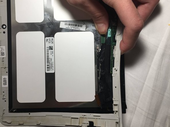

  5. HP x2 10-p010wm Screen Replacement: crwdns2935265:05crwdnd2935265:01crwdnd2935265:02crwdne2935265:0 HP x2 10-p010wm Screen Replacement: crwdns2935265:05crwdnd2935265:02crwdnd2935265:02crwdne2935265:0
    • Remove the frame.
