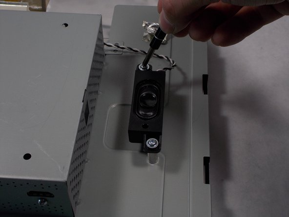

  9. HP w2216h Video Port Board Replacement: crwdns2935265:09crwdnd2935265:01crwdnd2935265:02crwdne2935265:0 HP w2216h Video Port Board Replacement: crwdns2935265:09crwdnd2935265:02crwdnd2935265:02crwdne2935265:0
    • Remove the two 8mm Philips #000 head screws on each speaker.

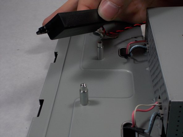

  10. HP w2216h Video Port Board Replacement: crwdns2935265:010crwdnd2935265:01crwdnd2935265:02crwdne2935265:0 HP w2216h Video Port Board Replacement: crwdns2935265:010crwdnd2935265:02crwdnd2935265:02crwdne2935265:0
    • Remove the speakers by lifting them vertically from the screen assembly.

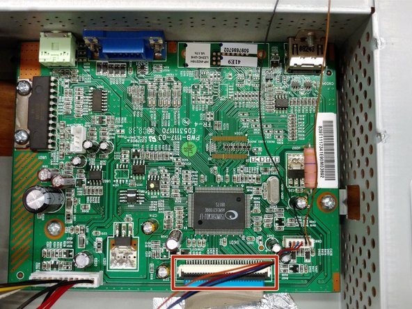

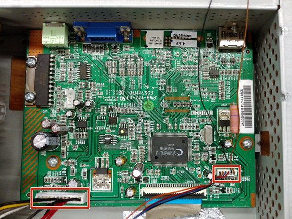

  14. HP w2216h Video Port Board Replacement: crwdns2935265:014crwdnd2935265:01crwdnd2935265:03crwdne2935265:0 HP w2216h Video Port Board Replacement: crwdns2935265:014crwdnd2935265:02crwdnd2935265:03crwdne2935265:0 HP w2216h Video Port Board Replacement: crwdns2935265:014crwdnd2935265:03crwdnd2935265:03crwdne2935265:0
    • Remove all 8mm Phillips #000 screws holding the board in place.
    • Remove the ribbon cable towards the bottom of the board by sliding the cable away from the board.
    • Remove both wire busses still on the board.
