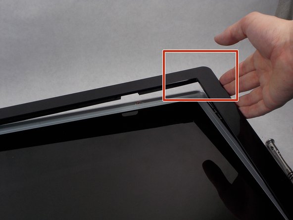

    • Do not put the metal spudger between the metal and the glass. It needs to go under the bezel and above the metal.
    • Turn monitor so that the screen is facing you.
    • Pry the black bezel from above the metal by placing your metal spudger between the bezel and the metal and twisting the tool slightly.
    • The best places to pry are in the lower left and lower right corners of the black bezel.

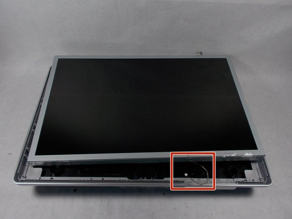

    • Be careful of the wires attaching the power button and the control buttons. Show extreme caution to ensure the button is not damaged.
    • Lift the screen assembly from the plastic housing from the corners.

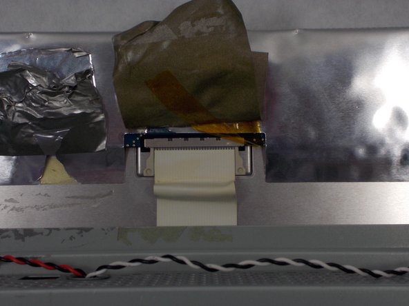

    • Lift the gray tape of the top of the monitor to expose the ribbon cable.
    • Remove the ribbon cable by sliding the connector towards the center of the screen assembly.
    • Lift the reflective tape next to the gray tape.
