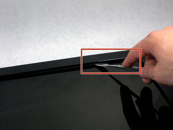

    • Do not put the metal spudger between the metal and the glass. It needs to go under the bezel and above the metal.
    • Turn monitor so that the screen is facing you.
    • Pry the black bezel from above the metal by placing your metal spudger between the bezel and the metal and twisting the tool slightly.
    • The best places to pry are in the lower left and lower right corners of the black bezel.

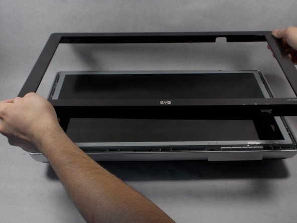

  4. HP w2216h Control Buttons Replacement: crwdns2935265:04crwdnd2935265:01crwdnd2935265:01crwdne2935265:0
    • Lift the screen assembly from the plastic housing from the corners.

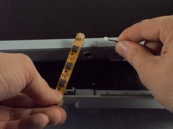

  5. HP w2216h Control Buttons Replacement: crwdns2935265:05crwdnd2935265:01crwdnd2935265:01crwdne2935265:0
    • Remove the plastic buttons from the contacts
  6. HP w2216h Control Buttons Replacement: crwdns2935265:06crwdnd2935265:01crwdnd2935265:02crwdne2935265:0 HP w2216h Control Buttons Replacement: crwdns2935265:06crwdnd2935265:02crwdnd2935265:02crwdne2935265:0
    • Remove the wire connecting the contacts to the screen assembly.
