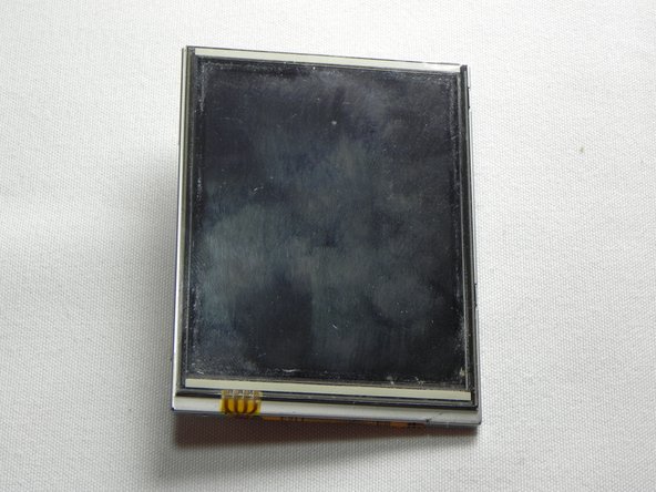

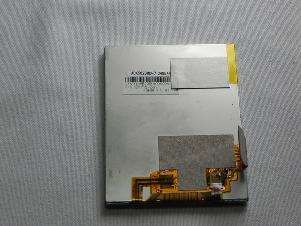

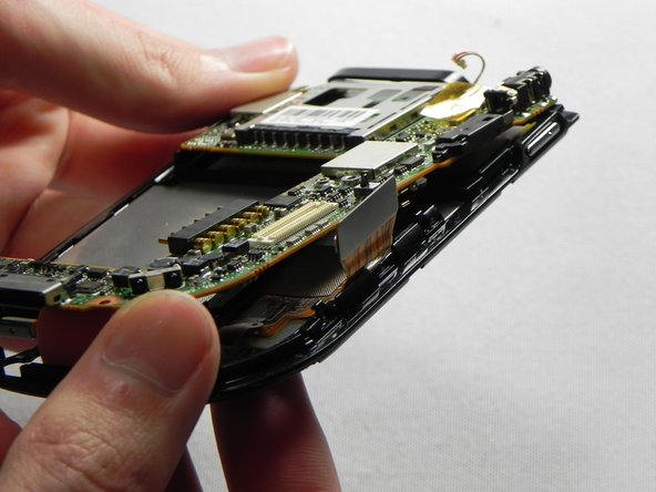

    • Now that the front cover is removed we can detach the screen
    • Remove the ribbon connector by pulling gently on the silver top. It will snap off the mother board.
    • The ribbon cable and connector can be easily removed if you genetly lift up the motherboard to create a small gap
  13. HP iPAQ h4155 LCD screen replacement: crwdns2935265:013crwdnd2935265:01crwdnd2935265:03crwdne2935265:0 HP iPAQ h4155 LCD screen replacement: crwdns2935265:013crwdnd2935265:02crwdnd2935265:03crwdne2935265:0 HP iPAQ h4155 LCD screen replacement: crwdns2935265:013crwdnd2935265:03crwdnd2935265:03crwdne2935265:0
    • Now the screen can be removed
