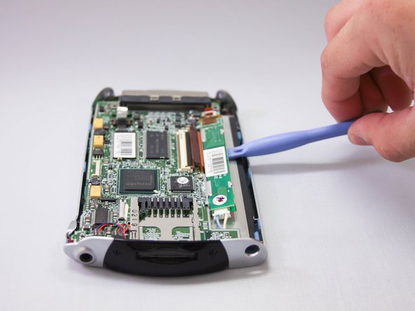

  5. HP iPAQ H3850 Speaker Replacement: crwdns2935265:05crwdnd2935265:01crwdnd2935265:01crwdne2935265:0
    • Remove ribbon cable connected to iPAQ speaker logic board by pulling plastic clips on both sides towards top of iPAQ speaker.
    • Use plastic opening tool to carefully pull brown ribbon cable from connector.

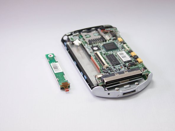

  6. HP iPAQ H3850 Speaker Replacement: crwdns2935265:06crwdnd2935265:01crwdnd2935265:03crwdne2935265:0 HP iPAQ H3850 Speaker Replacement: crwdns2935265:06crwdnd2935265:02crwdnd2935265:03crwdne2935265:0 HP iPAQ H3850 Speaker Replacement: crwdns2935265:06crwdnd2935265:03crwdnd2935265:03crwdne2935265:0
    • Use plastic opening tool to carefully remove display logic board from housing.
    • Unplug connector from the opposite end of the display logic board.
    • Completely remove component.

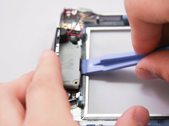

  11. HP iPAQ H3850 Speaker Replacement: crwdns2935265:011crwdnd2935265:01crwdnd2935265:03crwdne2935265:0 HP iPAQ H3850 Speaker Replacement: crwdns2935265:011crwdnd2935265:02crwdnd2935265:03crwdne2935265:0 HP iPAQ H3850 Speaker Replacement: crwdns2935265:011crwdnd2935265:03crwdnd2935265:03crwdne2935265:0
    • At the top of the iPAQ remove the screws holding down the speaker and housing.

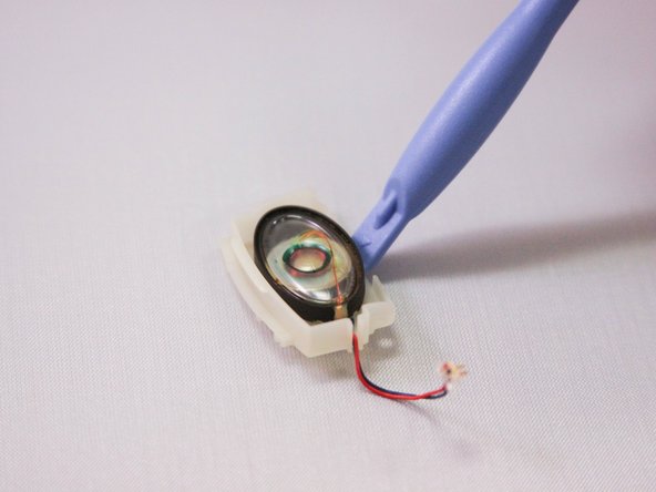

    • When the screws are out pry out speaker along with the housing.
    • Lay down the speaker and housing with the housing on the bottom side and pry out the speaker with the plastic opening tool.
