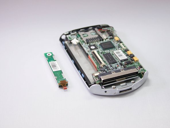

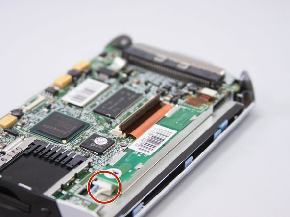

  7. HP iPAQ H3850 Screen Replacement: crwdns2935265:07crwdnd2935265:01crwdnd2935265:03crwdne2935265:0 HP iPAQ H3850 Screen Replacement: crwdns2935265:07crwdnd2935265:02crwdnd2935265:03crwdne2935265:0 HP iPAQ H3850 Screen Replacement: crwdns2935265:07crwdnd2935265:03crwdnd2935265:03crwdne2935265:0
    • Use the plastic opening tool to carefully remove the display logic board from its housing.
    • Unplug connector from the opposite end of the display logic board.
    • Completely remove component.
