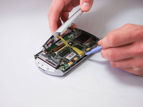

  3. HP iPAQ H3850 Buttons Replacement: crwdns2935265:03crwdnd2935265:01crwdnd2935265:02crwdne2935265:0 HP iPAQ H3850 Buttons Replacement: crwdns2935265:03crwdnd2935265:02crwdnd2935265:02crwdne2935265:0
    • Carefully remove the back cover using the plastic opening tool against the grooves along the sides of the iPAQ.
    • At this point, a yellow ribbon will be connecting both the front and back panels of the device. Carefully use the plastic opening tool to detach the ribbon from the connector pins.

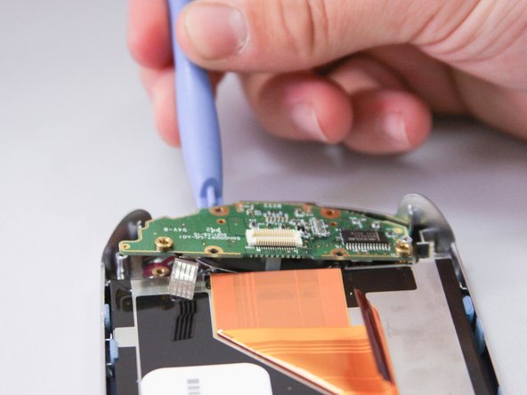

  4. HP iPAQ H3850 Buttons Replacement: crwdns2935265:04crwdnd2935265:01crwdnd2935265:01crwdne2935265:0
    • Remove the ribbon cable connected to the display motherboard by pulling the plastic clips on both sides towards the top of the device.
    • Use a plastic opening tool to carefully pull the brown ribbon cable from the connector.

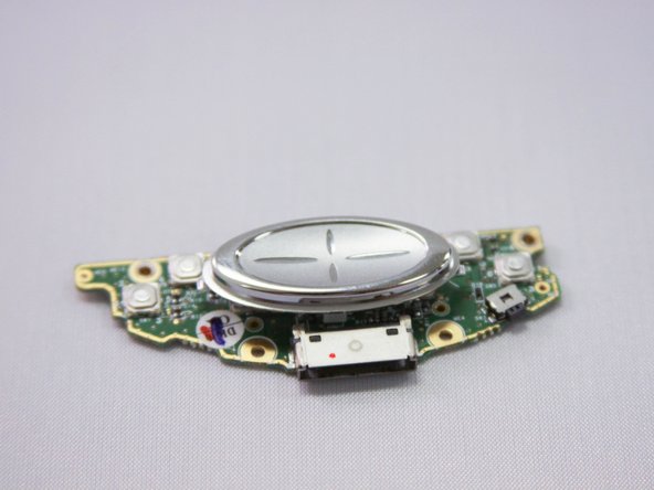

  6. HP iPAQ H3850 Buttons Replacement: crwdns2935265:06crwdnd2935265:01crwdnd2935265:02crwdne2935265:0 HP iPAQ H3850 Buttons Replacement: crwdns2935265:06crwdnd2935265:02crwdnd2935265:02crwdne2935265:0
    • Remove three small screws from the corners of the motherboard using a Phillips head screwdriver.
    • Use your hands or plastic opening tool to carefully lift the motherboard out of its housing.

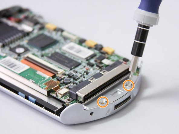

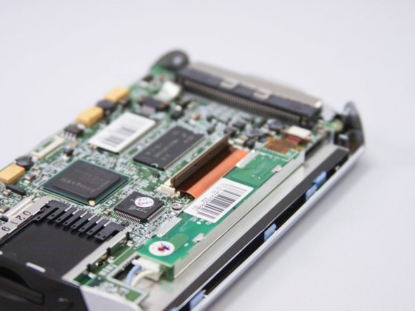

    • Remove two screws from the silver cover using a Phillips #00 screwdriver.

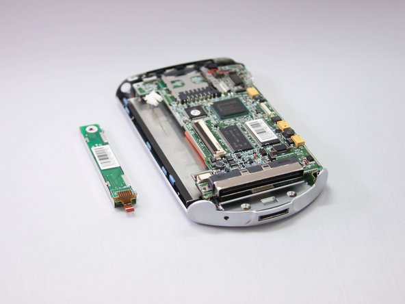

  7. HP iPAQ H3850 Buttons Replacement: crwdns2935265:07crwdnd2935265:01crwdnd2935265:03crwdne2935265:0 HP iPAQ H3850 Buttons Replacement: crwdns2935265:07crwdnd2935265:02crwdnd2935265:03crwdne2935265:0 HP iPAQ H3850 Buttons Replacement: crwdns2935265:07crwdnd2935265:03crwdnd2935265:03crwdne2935265:0
    • Use a Phillips #00 screwdriver to remove the two screws at the bottom of the device.
    • Use a plastic opening tool to remove the button motherboard.
