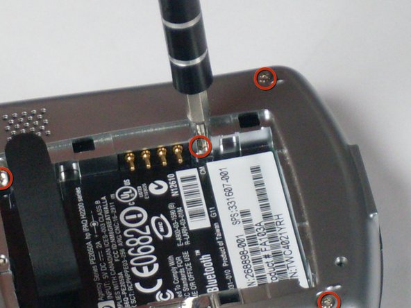

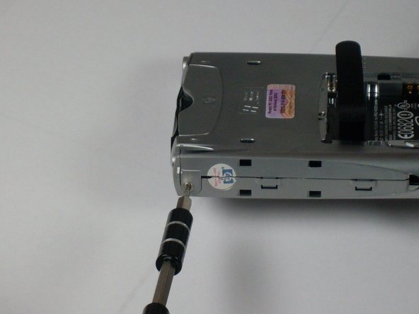

  6. HP iPAQ H2200 motherbaord replacement: crwdns2935265:06crwdnd2935265:01crwdnd2935265:03crwdne2935265:0 HP iPAQ H2200 motherbaord replacement: crwdns2935265:06crwdnd2935265:02crwdnd2935265:03crwdne2935265:0 HP iPAQ H2200 motherbaord replacement: crwdns2935265:06crwdnd2935265:03crwdnd2935265:03crwdne2935265:0
    • Using the T5 Torx screwdriver, remove all six screws on the back and all screws on each side of the device.

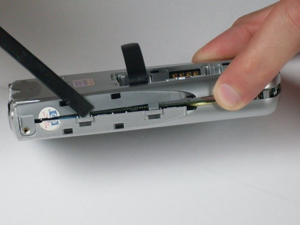

  7. HP iPAQ H2200 motherbaord replacement: crwdns2935265:07crwdnd2935265:01crwdnd2935265:02crwdne2935265:0 HP iPAQ H2200 motherbaord replacement: crwdns2935265:07crwdnd2935265:02crwdnd2935265:02crwdne2935265:0
    • Remove the back faceplate by pushing and loosening the 4 side slots (2 on each side).
