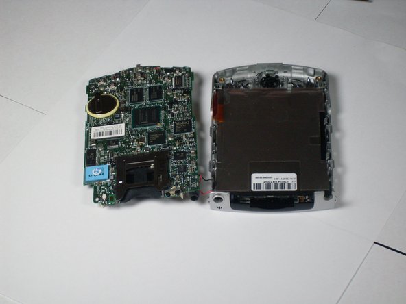

    • Open the LCD connector, where the orange strip attaches to the main board.
  9. HP iPAQ H2200 faceplate replacement: crwdns2935265:09crwdnd2935265:01crwdnd2935265:01crwdne2935265:0
    • Carefully remove the orange LCD strip from the connector.
  10. HP iPAQ H2200 faceplate replacement: crwdns2935265:010crwdnd2935265:01crwdnd2935265:01crwdne2935265:0
    • Unscrew the 2 screws located at each top corner of the main board.
  11. HP iPAQ H2200 faceplate replacement: crwdns2935265:011crwdnd2935265:01crwdnd2935265:01crwdne2935265:0
    • Remove the main board by pushing outward on the two tabs located on each side near the bottom of the device.
  12. HP iPAQ H2200 faceplate replacement, LCD Screen: crwdns2935265:012crwdnd2935265:01crwdnd2935265:01crwdne2935265:0
    • Unscrew the two bottom screws on LCD screen that were previously located under the main board.
  13. HP iPAQ H2200 faceplate replacement: crwdns2935265:013crwdnd2935265:01crwdnd2935265:02crwdne2935265:0 HP iPAQ H2200 faceplate replacement: crwdns2935265:013crwdnd2935265:02crwdnd2935265:02crwdne2935265:0
    • Press on side tabs to loosen and remove the LCD screen.
