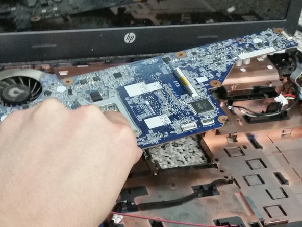

  8. HP g4 Heatsink/Fan (or Motherboard) Replacement, Remove motherboard: crwdns2935265:08crwdnd2935265:01crwdnd2935265:02crwdne2935265:0 HP g4 Heatsink/Fan (or Motherboard) Replacement, Remove motherboard: crwdns2935265:08crwdnd2935265:02crwdnd2935265:02crwdne2935265:0
    • Remove all marked cables from the motherboard.
    • The DC jack connector may require quite some pulling. Just pull it, it'll come out.
    • Also remove the single marked blue-painted screw.
    • The motherboard can now be lifted upwards.

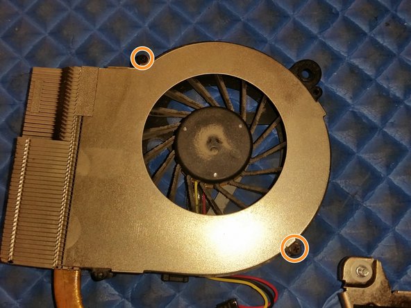

  10. HP g4 Heatsink/Fan (or Motherboard) Replacement, Remove fan clip & screws: crwdns2935265:010crwdnd2935265:01crwdnd2935265:03crwdne2935265:0 HP g4 Heatsink/Fan (or Motherboard) Replacement, Remove fan clip & screws: crwdns2935265:010crwdnd2935265:02crwdnd2935265:03crwdne2935265:0 HP g4 Heatsink/Fan (or Motherboard) Replacement, Remove fan clip & screws: crwdns2935265:010crwdnd2935265:03crwdnd2935265:03crwdne2935265:0
    • Bend the metal clip outwards.
    • Get out the Philips #0 bit, and remove the two very small Philips screws from the assembly.
    • Wiggle the fan out, separating it from the rest of the assembly.

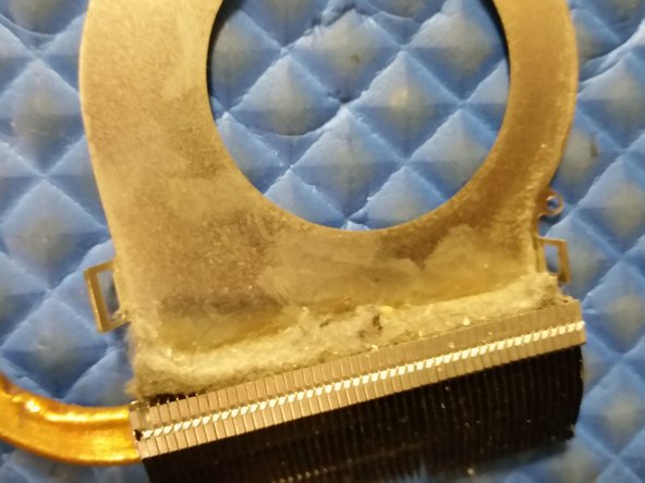

    • You're done! Check out that dust in this g4 in the third picture.
