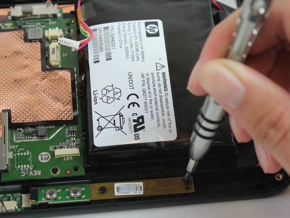

  7. HP eStation Zeen Motherboard Replacement: crwdns2935265:07crwdnd2935265:01crwdnd2935265:02crwdne2935265:0 HP eStation Zeen Motherboard Replacement: crwdns2935265:07crwdnd2935265:02crwdnd2935265:02crwdne2935265:0
    • Remove the two 6mm Phillips screws with Phillips #0 screwdriver.

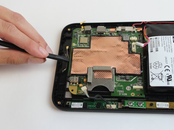

  8. HP eStation Zeen Motherboard Replacement: crwdns2935265:08crwdnd2935265:01crwdnd2935265:02crwdne2935265:0 HP eStation Zeen Motherboard Replacement: crwdns2935265:08crwdnd2935265:02crwdnd2935265:02crwdne2935265:0
    • Pry off the clips that hold the motherboard down with the plastic spudger.

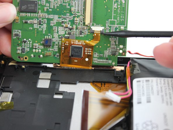

  9. HP eStation Zeen Motherboard Replacement: crwdns2935265:09crwdnd2935265:01crwdnd2935265:02crwdne2935265:0 HP eStation Zeen Motherboard Replacement: crwdns2935265:09crwdnd2935265:02crwdnd2935265:02crwdne2935265:0
    • Lift motherboard up to expose the ribbons on the back.
    • Lift the grey tabs to disconnect the ribbons with plastic spudger.
