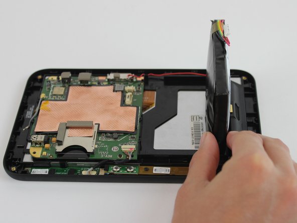

    • Remove the screw caps using a metal spudger.
    • Remove the four 6mm screws using a Phillips #0 screwdriver.
  2. HP eStation Zeen Battery Replacement: crwdns2935265:02crwdnd2935265:01crwdnd2935265:03crwdne2935265:0 HP eStation Zeen Battery Replacement: crwdns2935265:02crwdnd2935265:02crwdnd2935265:03crwdne2935265:0 HP eStation Zeen Battery Replacement: crwdns2935265:02crwdnd2935265:03crwdnd2935265:03crwdne2935265:0
    • Unclip each side by inserting a plastic opening tool and slide it along edges.
    • Remove the back panel by lifting the panel away from the device.
  3. HP eStation Zeen Battery Replacement: crwdns2935265:03crwdnd2935265:01crwdnd2935265:01crwdne2935265:0
    • Disconnect the battery clip with a plastic opening tool.
    • The clip is very fragile.
  4. HP eStation Zeen Battery Replacement: crwdns2935265:04crwdnd2935265:01crwdnd2935265:02crwdne2935265:0 HP eStation Zeen Battery Replacement: crwdns2935265:04crwdnd2935265:02crwdnd2935265:02crwdne2935265:0
    • Remove the battery using the plastic opening tool.
    • There is glue holding the battery down so it will require some effort.
