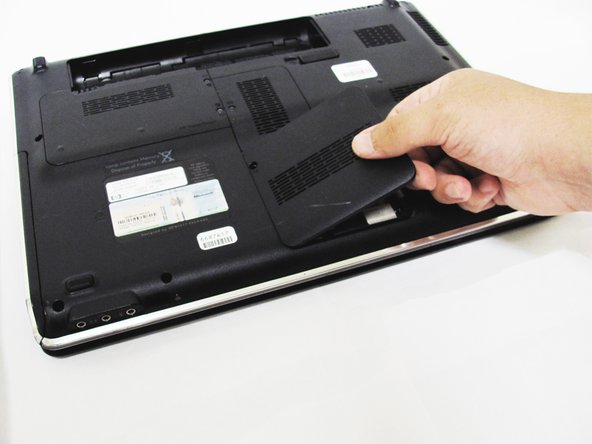

  4. HP dv5-1125nr Fan Replacement: crwdns2935265:04crwdnd2935265:01crwdnd2935265:01crwdne2935265:0
    • Remove the plastic hard drive cover.

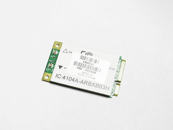

  8. HP dv5-1125nr Fan Replacement, WLAN Card: crwdns2935265:08crwdnd2935265:01crwdnd2935265:01crwdne2935265:0
    • Locate the wireless card and the two wires attached to it.
    • Caution: Prying on the WLAN card wires in the wrong direction could damage your wireless card. Make sure to lift straight up when removing the wires.
    • Using a plastic spudger tool, carefully lift up on each wire connecting the card to unsnap the connectors.
  9. HP dv5-1125nr Fan Replacement: crwdns2935265:09crwdnd2935265:01crwdnd2935265:02crwdne2935265:0 HP dv5-1125nr Fan Replacement: crwdns2935265:09crwdnd2935265:02crwdnd2935265:02crwdne2935265:0
    • Locate the 2.5mm Phillips screw on the corner of the WLAN card and remove it using a Phillips #000 screwdriver.
  10. HP dv5-1125nr Fan Replacement: crwdns2935265:010crwdnd2935265:01crwdnd2935265:02crwdne2935265:0 HP dv5-1125nr Fan Replacement: crwdns2935265:010crwdnd2935265:02crwdnd2935265:02crwdne2935265:0
    • Upon removing the screw, the WLAN card will pop up. Keeping a natural angle, slide the card out of the slot.
    • The card is now free from your computer.

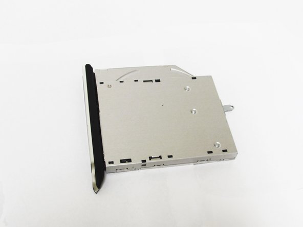

  12. HP dv5-1125nr Fan Replacement: crwdns2935265:012crwdnd2935265:01crwdnd2935265:03crwdne2935265:0 HP dv5-1125nr Fan Replacement: crwdns2935265:012crwdnd2935265:02crwdnd2935265:03crwdne2935265:0 HP dv5-1125nr Fan Replacement: crwdns2935265:012crwdnd2935265:03crwdnd2935265:03crwdne2935265:0
    • The optical drive is now ready for removal. Using a plastic removal tool, lift the optical drive away from your computer.
    • Using your hands, slide the remainder of the drive out of the computer.

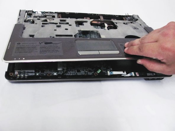

  23. HP dv5-1125nr Fan Replacement: crwdns2935265:023crwdnd2935265:01crwdnd2935265:02crwdne2935265:0 HP dv5-1125nr Fan Replacement: crwdns2935265:023crwdnd2935265:02crwdnd2935265:02crwdne2935265:0
    • Flip the laptop, and use the plastic opening tool on the side seam to remove the top cover.
    • You may need to use the opening tool on both sides of the cover.
    • Be careful not to break the ribbon cables under the cover.

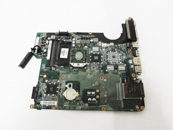

  40. HP dv5-1125nr Fan Replacement: crwdns2935265:040crwdnd2935265:01crwdnd2935265:01crwdne2935265:0
    • Make sure to ground yourself to a metal object before attempting to remove the motherboard. Static charge build-up is dangerous to electronics and may ruin your motherboard if not properly grounded.
    • Remove the motherboard from the laptop body, being careful to keep the modem board from dislodging itself.
    • Your motherboard is now removed.
