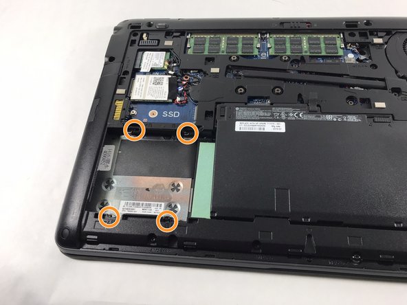

    • The hard drive is missing from this particular device. The hard drive is located next to the battery as indicated in red. It would normally be enclosed in a metal caddy with a black plastic tab extending toward the battery.
    • Use a Phillips #0 screwdriver to remove the four 3 mm screws that secure the drive.
    • Pull the black tab outward in the direction of where the battery was to remove the hard drive from the device.
