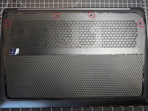

  1. HP ZBook Studio G3 Battery Replacement, Remove center plate: crwdns2935265:01crwdnd2935265:01crwdnd2935265:02crwdne2935265:0 HP ZBook Studio G3 Battery Replacement, Remove center plate: crwdns2935265:01crwdnd2935265:02crwdnd2935265:02crwdne2935265:0
    • Using the TR9 bit, remove the four center plate screws on the back of the laptop.
    • Note: All TR9 screws on this laptop are self-retaining - so they only need to be loosened, not completely removed from the panel.

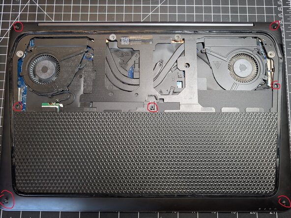

  2. HP ZBook Studio G3 Battery Replacement, Remove back panel: crwdns2935265:02crwdnd2935265:01crwdnd2935265:01crwdne2935265:0
    • Remove the 7 TR9 screws from the back panel, including the 3 hidden by the center panel.
