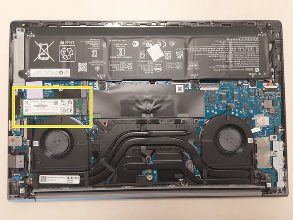

  3. HP ZBook Power G10 Thermal Paste Replacement, Upgrading the RAM and SSD (Optional): crwdns2935265:03crwdnd2935265:01crwdnd2935265:02crwdne2935265:0 HP ZBook Power G10 Thermal Paste Replacement, Upgrading the RAM and SSD (Optional): crwdns2935265:03crwdnd2935265:02crwdnd2935265:02crwdne2935265:0
    • Once you opened the back cover, it is a good idea to upgrade the RAM or the SSD if you want.
    • It is also recommended to use compressed air to remove any dust in the laptop and the fans.
