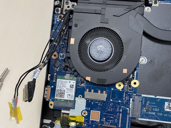

  2. HP ZBook Fury 15 G8 Thermal Paste Replacement, Reaching the cooling system.: crwdns2935265:02crwdnd2935265:01crwdnd2935265:02crwdne2935265:0 HP ZBook Fury 15 G8 Thermal Paste Replacement, Reaching the cooling system.: crwdns2935265:02crwdnd2935265:02crwdnd2935265:02crwdne2935265:0
    • Remove all the screws that hold the plastic protective cover and also remove the battery.
    • Remove the 3 screws below the battery and also unplug the connectors of the LAN and WAN modules if you have.
    • After all of the above has been done, you can lift the plastic protective cover. Be sure to do it carefully!

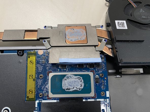

  3. HP ZBook Fury 15 G8 Thermal Paste Replacement, Removing the cooling system.: crwdns2935265:03crwdnd2935265:01crwdnd2935265:02crwdne2935265:0 HP ZBook Fury 15 G8 Thermal Paste Replacement, Removing the cooling system.: crwdns2935265:03crwdnd2935265:02crwdnd2935265:02crwdne2935265:0
    • Unplug the display and fan cables and route them away.
    • Unscrew the fans and CPU pipes.
  4. HP ZBook Fury 15 G8 Thermal Paste Replacement, Changing the thermal paste.: crwdns2935265:04crwdnd2935265:01crwdnd2935265:02crwdne2935265:0 HP ZBook Fury 15 G8 Thermal Paste Replacement, Changing the thermal paste.: crwdns2935265:04crwdnd2935265:02crwdnd2935265:02crwdne2935265:0
    • Clean the old thermal paste both from the cooler and the CPU. It is best to use isopropyl alcohol and cotton swabs or paper towel, but be careful not to go too hard on the CPU.
    • Don`t use too much thermal paste, just enough to cover some portion of the pad. If you have a spreader, use it. The thermal paste will apply evenly after you tighten the heatsink.
  5. HP ZBook Fury 15 G8 Thermal Paste Replacement, Upgrading the RAM and SSD (Optional): crwdns2935265:05crwdnd2935265:01crwdnd2935265:01crwdne2935265:0
    • Once you opened the back cover, it is a good idea to upgrade the RAM or the SSD if you want.
    • This laptops has 4 DIMM slots. 2 in the back and 2 behind the keyboard.
    • Also 2 m.2 SSD slots: 1 in the back and 1 behind the keyboard. As well as a full size laptop SSD in the back, behind the battery.
    • It is also recommended to use compressed air to remove any dust in the laptop and the fans.

Hey, my computer has a thermal issue leading to freeze - after 3 years of use. A colleague of mine had the same issue, probably much earlier.
Do you have to change the GPU thermal paste as well? The HP manual found on ifixit also says, that are thermal pads. I am thinking about changing everything at once. Kind regards and thanks for your manual!
BJfix - crwdns2934203:0crwdne2934203:0
Hello, this particular HP ZBook Fury 15 G8 does only have an integrated GPU, so I do not know the motherboard layout of the model with an external one. Overall it should be enough to replace the thermal paste of the CPU and GPU without replacing the thermal pads (if there are any, and are in okay quality, not ripped apart or hard). Once you lift up the heatsink, replacing the thermal paste everywhere below it is mandatory.
Simeon Brankov -
Thanks! We have the Nvidia Quattro GPU. Based on the Hardware Monitor, i tend to think that the pc freezes once the GPU reaches around 60-68 °C, which happend to me even without 3D Applications, just Teams and Onedrive.
