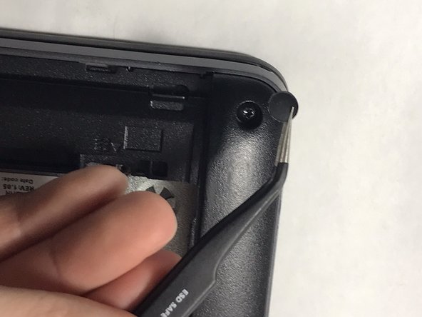

    • Use a pair of tweezers to remove the rubber feet at the edges and corners of the laptop to reveal the other 8 torx screws and remove them as well

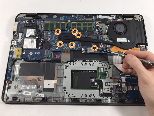

    • Loosen the 2 silver Phillips screws on the fan assembly.
    • Remove the 6 Phillips screws at the left side of the heatsink assembly.

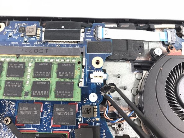

    • Using tweezers, gently unplug the wire the connects the fan to the motherboard.
