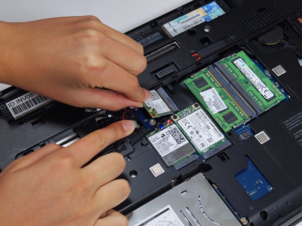

HP ZBook 15 Wi-Fi Card Replacement
  1. HP ZBook 15 Wi-Fi Card Replacement, Battery: crwdns2935265:01crwdnd2935265:01crwdnd2935265:02crwdne2935265:0 HP ZBook 15 Wi-Fi Card Replacement, Battery: crwdns2935265:01crwdnd2935265:02crwdnd2935265:02crwdne2935265:0
    • Flip the laptop over.
    • Slide the lever with the battery symbol beside it firmly until the battery pops out.
    • Remove the battery from the laptop.
  2. HP ZBook 15 Wi-Fi Card Replacement, Back Cover: crwdns2935265:02crwdnd2935265:01crwdnd2935265:01crwdne2935265:0
    • Slide the right lever firmly to the right.
    • Slide the cover towards yourself to remove it.
  3. HP ZBook 15 Wi-Fi Card Replacement, Wi-Fi Card: crwdns2935265:03crwdnd2935265:01crwdnd2935265:01crwdne2935265:0
    • Lift up the two tabs connected to wires.
  4. HP ZBook 15 Wi-Fi Card Replacement: crwdns2935265:04crwdnd2935265:01crwdnd2935265:02crwdne2935265:0 HP ZBook 15 Wi-Fi Card Replacement: crwdns2935265:04crwdnd2935265:02crwdnd2935265:02crwdne2935265:0
    • Remove the two 3mm screws from the corners of the card with a Phillips #0 screwdriver.
    • Lift the card up and slide it out to disconnect it.
