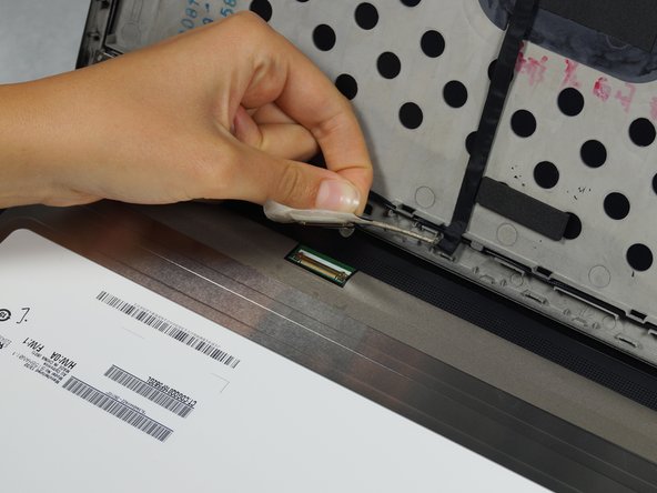

    5. HP ZBook 15 Screen Replacement: crwdns2935265:06crwdnd2935265:01crwdnd2935265:02crwdne2935265:0 HP ZBook 15 Screen Replacement: crwdns2935265:06crwdnd2935265:02crwdnd2935265:02crwdne2935265:0
      • Do not peel the tape from the side closest to the bottom of the screen panel! This may rip out the connector's wires.
      • Gently lower the screen and lay it face down on the keyboard.
      • Lift the corners of the tape closest to the top of the screen and peel toward the center carefully.
      • Slowly pull the tape away from the sides.
      • Lift the tape and disconnect the screen connector.
      • You can leave the tape stuck to the cable connector and still be able to remove it.

Worked great! Only caution that I would add is that on one of the machines I took apart, the adhesive strip behind the bottom of the bezel stuck to the bezel and not the circuit board behind. I had to carefully slide my finger between the adhesive strip and the bezel to separate them. Once the bezel was removed, I was able to stick the adhesive back down. I think this laptop may have been exposed to some sort of liquid, so this may not be a common issue.
