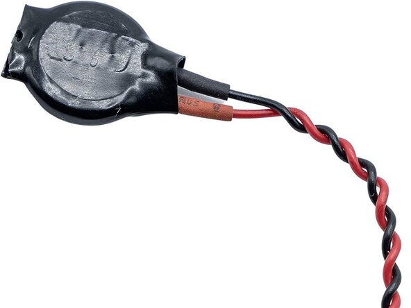

    • You need to have a CR 2032 battery that looks as following for the swap.

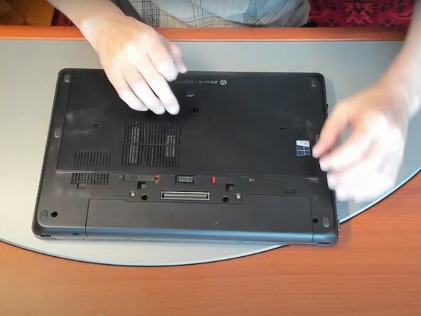

    • Flip over your laptop.
  3. HP ZBook 15 G2 CMOS Battery Replacement, Open it up.: crwdns2935265:03crwdnd2935265:01crwdnd2935265:02crwdne2935265:0 HP ZBook 15 G2 CMOS Battery Replacement, Open it up.: crwdns2935265:03crwdnd2935265:02crwdnd2935265:02crwdne2935265:0
    • Pull this latch and back cover should come off.
  4. HP ZBook 15 G2 CMOS Battery Replacement, Locate and take out the battery.: crwdns2935265:04crwdnd2935265:01crwdnd2935265:01crwdne2935265:0
    • It is in the red circle, and to remove it just grab the part that plugs in and pull it out.
    • Then, insert your other battery and put your cover back on. And that's it.
