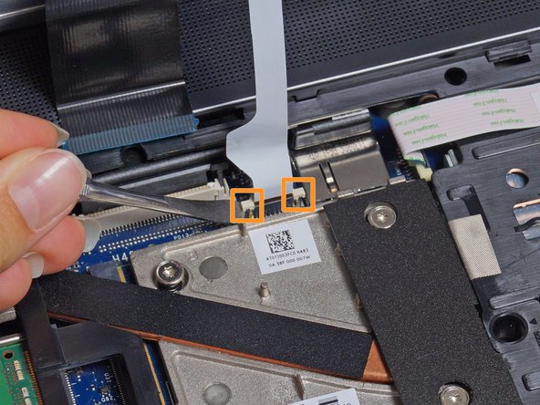

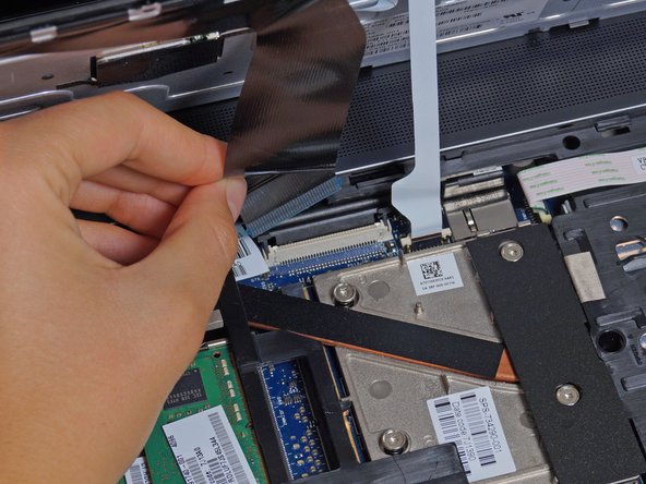

  17. HP ZBook 15 Fan and Heatsink Replacement: crwdns2935265:017crwdnd2935265:01crwdnd2935265:02crwdne2935265:0 HP ZBook 15 Fan and Heatsink Replacement: crwdns2935265:017crwdnd2935265:02crwdnd2935265:02crwdne2935265:0
    • Angle the top cover so you can see the white ribbons shown in the picture.
    • Carefully slide the top cover toward you to expose the white ribbon connectors.
    • Use a spudger to lift the connectors and slide out both ribbons.
