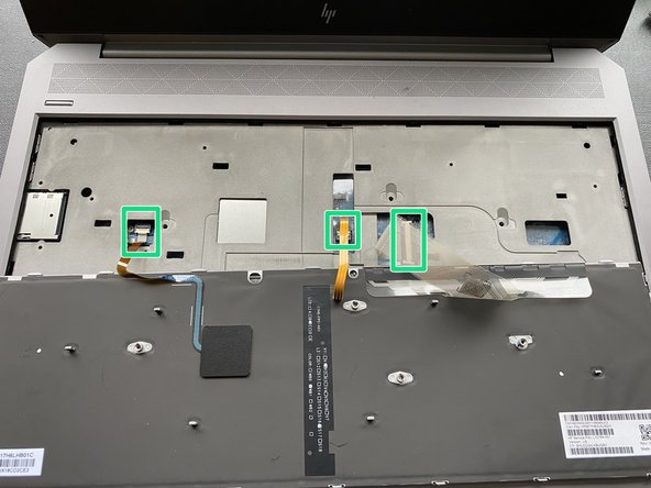

  3. HP ZBOOK 15 G5 Motherboard Replacement, Removing the Keyboard: crwdns2935265:03crwdnd2935265:01crwdnd2935265:02crwdne2935265:0 HP ZBOOK 15 G5 Motherboard Replacement, Removing the Keyboard: crwdns2935265:03crwdnd2935265:02crwdnd2935265:02crwdne2935265:0
    • Unscrew the three keyboard screws on the bottom
    • While placing the laptop on it's side, push through the hole to release the keyboard
    • Once the latch releases, flip over the laptop and disconnect the three connectors as well
    • Place the keyboard to the side and flip the laptop over again

Is it necessary to remove the keyboard if one is just swapping out the fans?
Burtimus - crwdns2934203:0crwdne2934203:0
Answer: No, the keyboard does not have to be removed to swap out the fans .
