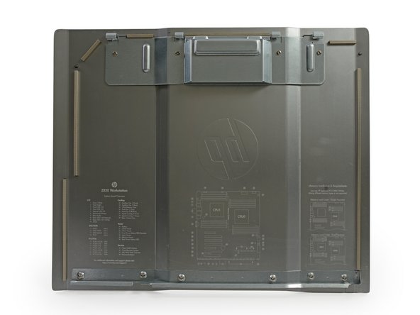

  3. HP Z820 Teardown: crwdns2935265:03crwdnd2935265:01crwdnd2935265:03crwdne2935265:0 HP Z820 Teardown: crwdns2935265:03crwdnd2935265:02crwdnd2935265:03crwdne2935265:0 HP Z820 Teardown: crwdns2935265:03crwdnd2935265:03crwdnd2935265:03crwdne2935265:0
    • Flip this, pull that, open it right up, the Z820's side panel pops off with the greatest of ease.
    • Our motherboard's map is conveniently etched on the interior of the side panel, directing us to all of the riches, and the proper loading order for RAM installation.
    • We love a good treasure map, and HP seems happy to provide them.
    • The Mac Pro features a similarly easy-to-open case, so we're one for one so far. But for how long?

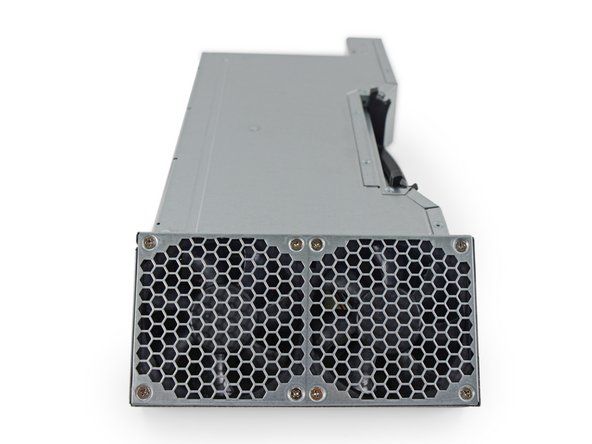

    • Welcome to the space station Z820. Here you will find green-labeled access handles for all of your upgrade and maintenance needs:
    • Power supply unit
    • CPU fan assembly
    • Optical drive release lever
    • Lower case shroud
    • Hard drive release catches

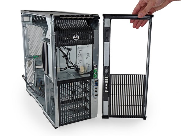

  6. HP Z820 Teardown: crwdns2935265:06crwdnd2935265:01crwdnd2935265:03crwdne2935265:0 HP Z820 Teardown: crwdns2935265:06crwdnd2935265:02crwdnd2935265:03crwdne2935265:0 HP Z820 Teardown: crwdns2935265:06crwdnd2935265:03crwdnd2935265:03crwdne2935265:0
    • Bulk and weight are certainly of interest, but this is iFixit, so let's talk repairability.
    • Our Mac Pro guides show you everything you need to know to replace the power supply, in 26 easy steps.
    • But what if you need to replace the power supply in your Z820? Remove scores of screws, some motherboard power connectors, flip some flops? ...oh wait, we're done.
    • We're pretty sure this is gonna be a recurring theme for this tower, so we'll try our best not to overdo the repair-compares.

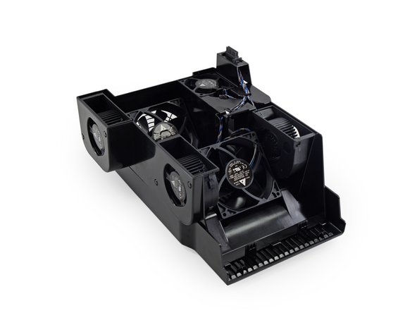

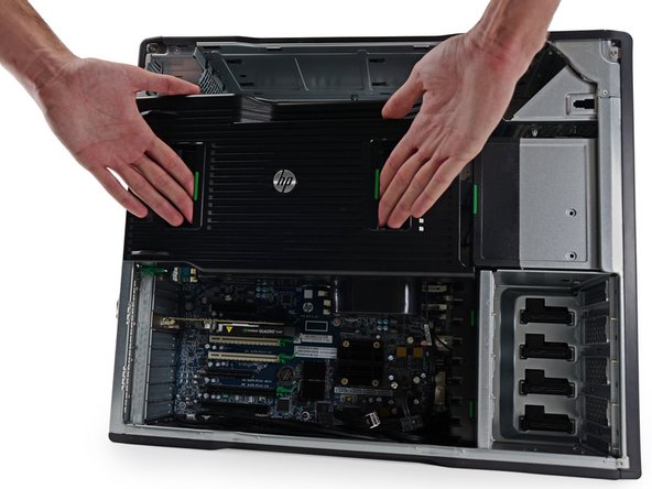

  7. HP Z820 Teardown: crwdns2935265:07crwdnd2935265:01crwdnd2935265:03crwdne2935265:0 HP Z820 Teardown: crwdns2935265:07crwdnd2935265:02crwdnd2935265:03crwdne2935265:0 HP Z820 Teardown: crwdns2935265:07crwdnd2935265:03crwdnd2935265:03crwdne2935265:0
    • Continuing our tool-less streak, let's see what's behind these huge panels. The lower is a fairly featureless cover that keeps your PCIe cards separate and cozy.
    • As for door number two's contents, if you follow us on Instagram, you'll have already seen this sweet piece of hardware.
    • Provided by our Instagram followers, here's a list of things this component isn't:
    • A printer of some kind
    • A miniaturized Portal 2 level
    • Пылесос (vacuum cleaner)
    • That carbon 3d printer by max idontknowhislastname

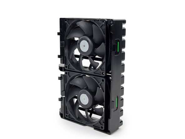

    • Surprise, it's the CPU fan array! Home to two main fans aligned to the CPU heat sinks, and four smaller fans to help the RAM modules keep their cool.

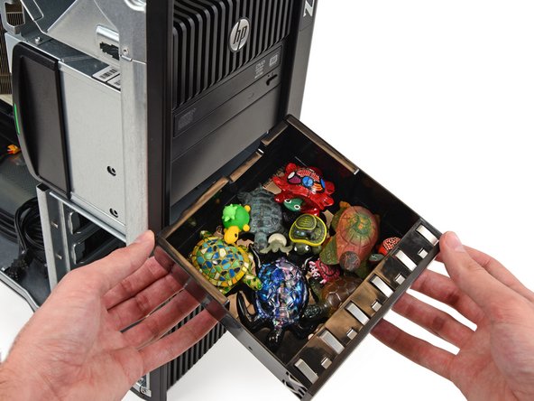

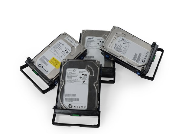

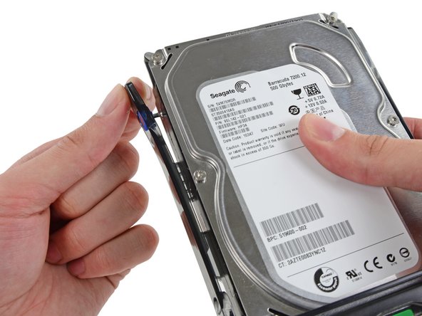

  10. HP Z820 Teardown: crwdns2935265:010crwdnd2935265:01crwdnd2935265:03crwdne2935265:0 HP Z820 Teardown: crwdns2935265:010crwdnd2935265:02crwdnd2935265:03crwdne2935265:0 HP Z820 Teardown: crwdns2935265:010crwdnd2935265:03crwdnd2935265:03crwdne2935265:0
    • A gentle tug on the drive release lever retracts spring-loaded pins from either side of the three drive bays, allowing us to easily free the filler block... full of turtles.*
    • The same trick releases the DVD+/-RW drive. Ordinary it may be, but useful if you want to re-watch old favorites unavailable on Netflix streaming.
    • * No turtles were actually provided by Hewlett Packard. iFixit makes no express or implied warranty to the effect that the Hewlett Packard Z820 workstation PC includes turtles, but holds that it would be totally rad.

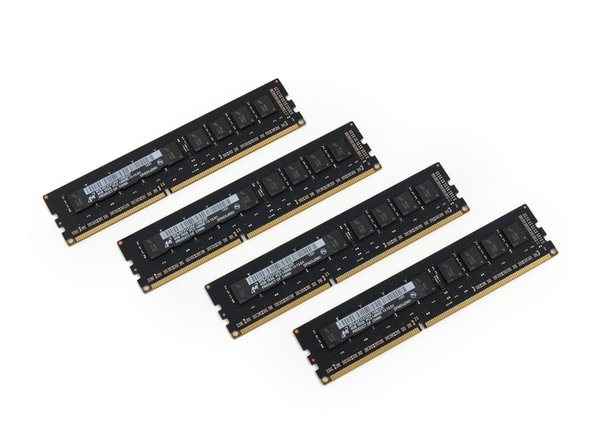

  11. HP Z820 Teardown: crwdns2935265:011crwdnd2935265:01crwdnd2935265:02crwdne2935265:0 HP Z820 Teardown: crwdns2935265:011crwdnd2935265:02crwdnd2935265:02crwdne2935265:0
    • To get to the RAM, we had to open the case and remove the fan assembly—one more step than the Mac Pro, so we'll kick a point to Apple for being slightly easier in this respect.
    • Once you do get to the treasure chamber, the Z820 has some mighty impressive upgrade opportunities.
    • 16 DIMM slots are laid out with 4 individual channels over 8 slots per CPU. Fully loaded, you'll be sporting 512 GB of 8-channel ECC DDR3, up to 1866 MHz.
    • You'll also be out over $10,000 for your efforts.
    • For what it's worth, our unit came loaded with 4 sticks of Micron 4 GB DDR3, for 16 GB total.

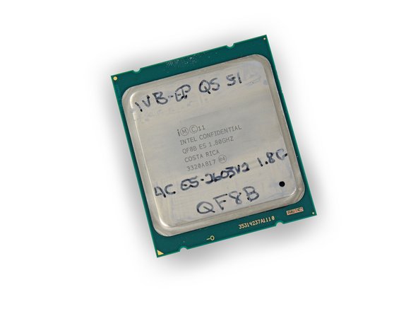

    • 'Sinks off, CPUs out. What's our cereal box PC prize to be?
    • A pair of Intel Confidential Xeon E5-2602 quad core processors!
    • The Intel Confidential stamp indicates that these are engineering sample processors, loaned out to folks (like HP) who'll be designing computers and applications utilizing its new tech before it hits the market.
    • That's something you won't find in your run-of-the-mill retail option.

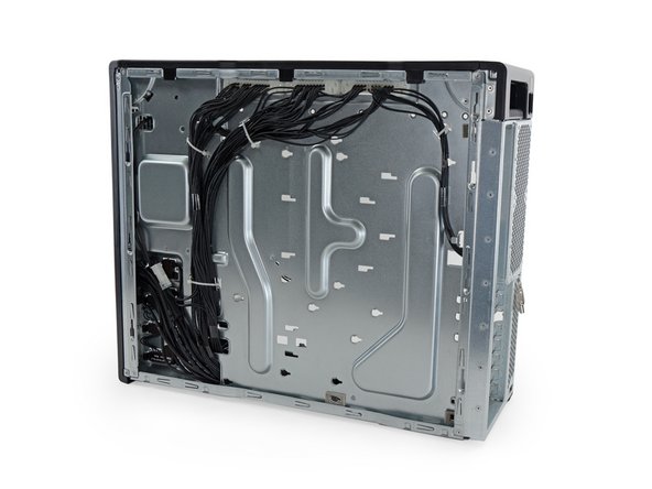

  17. HP Z820 Teardown: crwdns2935265:017crwdnd2935265:01crwdnd2935265:03crwdne2935265:0 HP Z820 Teardown: crwdns2935265:017crwdnd2935265:02crwdnd2935265:03crwdne2935265:0 HP Z820 Teardown: crwdns2935265:017crwdnd2935265:03crwdnd2935265:03crwdne2935265:0
    • After tunneling through the motherboard we realized the second side panel was hiding a secret compartment. A few failed attempts to open the hidden door reminded us that HP had our backs with their repair documentation.
    • Lo and behold there were some screws we'd missed and a sliding action we hadn't gotten quite right. Surprising no one, it's a lot easier to work on a machine that has a service manual!
    • Popping the side panel, we find some nicely bundled cables routed along the interior wall to poke into the main compartment. HP is good at this spring cleaning thing.
    • The front panel is now free to leave, allowing access to the power buttons and some port action.
