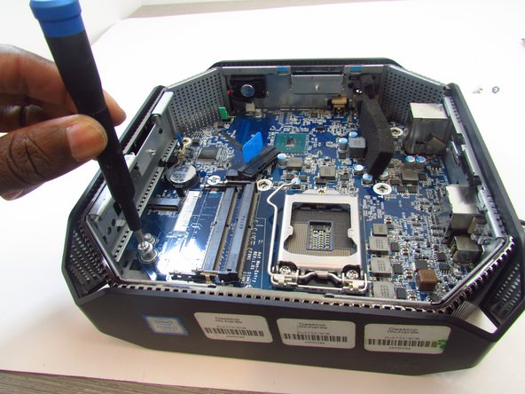

    1. HP Z2 Mini G3 Motherboard Replacement, Motherboard: crwdns2935265:013crwdnd2935265:01crwdnd2935265:03crwdne2935265:0 HP Z2 Mini G3 Motherboard Replacement, Motherboard: crwdns2935265:013crwdnd2935265:02crwdnd2935265:03crwdne2935265:0 HP Z2 Mini G3 Motherboard Replacement, Motherboard: crwdns2935265:013crwdnd2935265:03crwdnd2935265:03crwdne2935265:0
      • Remove the thermal sensor cable from the motherboard.
      • Grab and lift the cable from the chassis to finish removing the thermal sensor.
    2. HP Z2 Mini G3 Motherboard Replacement: crwdns2935265:014crwdnd2935265:01crwdnd2935265:01crwdne2935265:0
      • Some models may have a wireless LAN module installed under the GPU fan.
      • In this case, use a T15 Torx screwdriver to remove the 9mm Torx screw from the module and take the component out.
    3. HP Z2 Mini G3 Motherboard Replacement: crwdns2935265:015crwdnd2935265:01crwdnd2935265:01crwdne2935265:0
      • Unplug, then carefully detach the system speaker from the chassis by gripping the frame and pulling back.
      • You do not need to remove the speaker from its frame.
    4. HP Z2 Mini G3 Motherboard Replacement: crwdns2935265:016crwdnd2935265:01crwdnd2935265:02crwdne2935265:0 HP Z2 Mini G3 Motherboard Replacement: crwdns2935265:016crwdnd2935265:02crwdnd2935265:02crwdne2935265:0
      • Use a T15 Torx screw driver to remove the 9mm and the two 16mm Torx head screws that secure the motherboard to the chassis.
    5. HP Z2 Mini G3 Motherboard Replacement: crwdns2935265:017crwdnd2935265:01crwdnd2935265:02crwdne2935265:0 HP Z2 Mini G3 Motherboard Replacement: crwdns2935265:017crwdnd2935265:02crwdnd2935265:02crwdne2935265:0
      • Slide the motherboard forward and to the left to clear it from chassis.
      • Carefully pull and lift the motherboard out by holding on to the ports.
