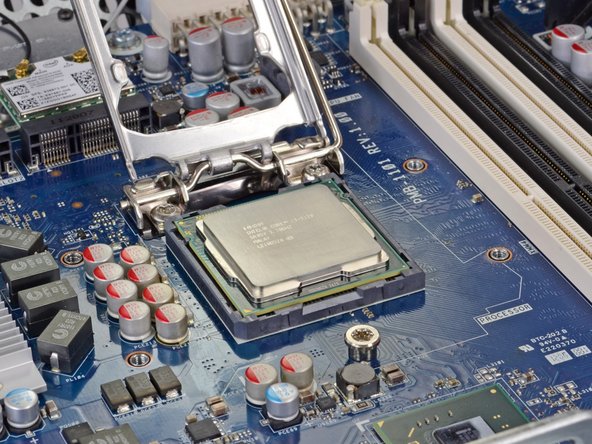

  13. HP Z1 Teardown: crwdns2935265:013crwdnd2935265:01crwdnd2935265:03crwdne2935265:0 HP Z1 Teardown: crwdns2935265:013crwdnd2935265:02crwdnd2935265:03crwdne2935265:0 HP Z1 Teardown: crwdns2935265:013crwdnd2935265:03crwdnd2935265:03crwdne2935265:0
    • This is almost too easy! A simple flip of a lever and the Intel processor practically jumps off the motherboard.
    • These days we mostly encounter soldered-on CPUs on laptops and smartphones, so it's a bit refreshing to touch and feel a nice hunk of CPU silicon in one's hand. Even though this machine is nothing like the PC beige-boxes some of us built back in the day, there's something comforting about holding a can-be-upgraded CPU and inspecting it up close.
    • Fake rumor confirmed: our Z1 did, in fact, come with an Intel Core i3 2120 processor, running at 3.30 GHz.
