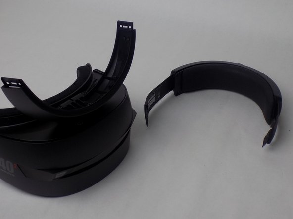

    • Peel off the adhesive foam on the front side of the headband.
    • When reassembling, you may have to manually reapply adhesive to get the foam back on.
  2. HP Windows Mixed Reality VR1000-100 Headband Replacement: crwdns2935265:02crwdnd2935265:01crwdnd2935265:02crwdne2935265:0 HP Windows Mixed Reality VR1000-100 Headband Replacement: crwdns2935265:02crwdnd2935265:02crwdnd2935265:02crwdne2935265:0
    • Remove the three screws holding the internal headband plate to the headband using a Phillips #00 screwdriver.
    • Pry off the internal headband plate using an opening tool.
  3. HP Windows Mixed Reality VR1000-100 Headband Replacement: crwdns2935265:03crwdnd2935265:01crwdnd2935265:02crwdne2935265:0 HP Windows Mixed Reality VR1000-100 Headband Replacement: crwdns2935265:03crwdnd2935265:02crwdnd2935265:02crwdne2935265:0
    • Remove four screws that hold the headband to the headset (two on each side) using a Phillips #00 screwdriver.
    • Using your hands, pull out the headband from the headset.
