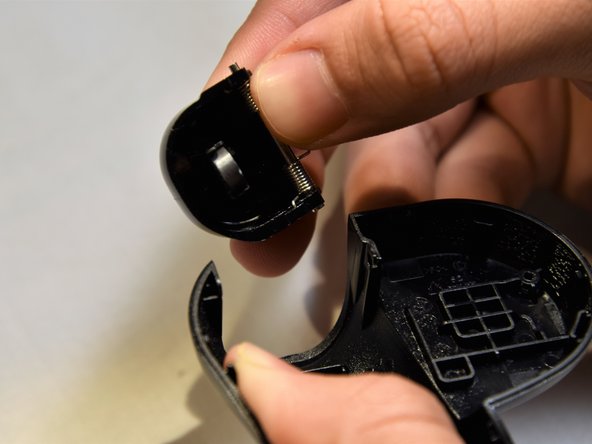

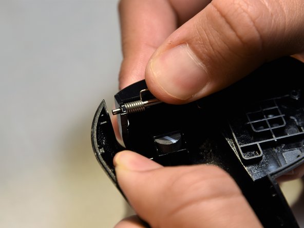

    1. HP Windows Mixed Reality Controllers TPC-Q044 Trigger Replacement, Trigger: crwdns2935265:05crwdnd2935265:01crwdnd2935265:03crwdne2935265:0 HP Windows Mixed Reality Controllers TPC-Q044 Trigger Replacement, Trigger: crwdns2935265:05crwdnd2935265:02crwdnd2935265:03crwdne2935265:0 HP Windows Mixed Reality Controllers TPC-Q044 Trigger Replacement, Trigger: crwdns2935265:05crwdnd2935265:03crwdnd2935265:03crwdne2935265:0
      • Grasp the trigger with one hand while pushing against the outer wall of the shell.
      • Apply pressure, pulling the wall away from the trigger.
      • Remove the trigger starting from the freed edge.
      • The spring-rod assembly can easily come apart. Inserting the large end first during reassembly may make the process easier.
