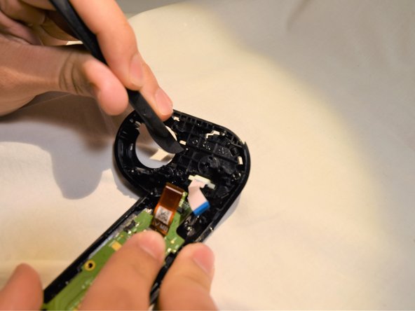

  4. HP Windows Mixed Reality Controllers TPC-Q044 Touch Pad   Replacement: crwdns2935265:04crwdnd2935265:01crwdnd2935265:02crwdne2935265:0 HP Windows Mixed Reality Controllers TPC-Q044 Touch Pad   Replacement: crwdns2935265:04crwdnd2935265:02crwdnd2935265:02crwdne2935265:0
    • Use a spudger to pry apart the two halves of the assembly.
    • Work slowly, prying a small section at a time until the halves are completely separated.

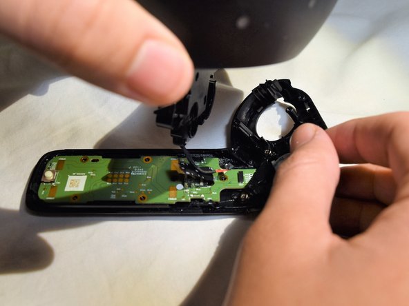

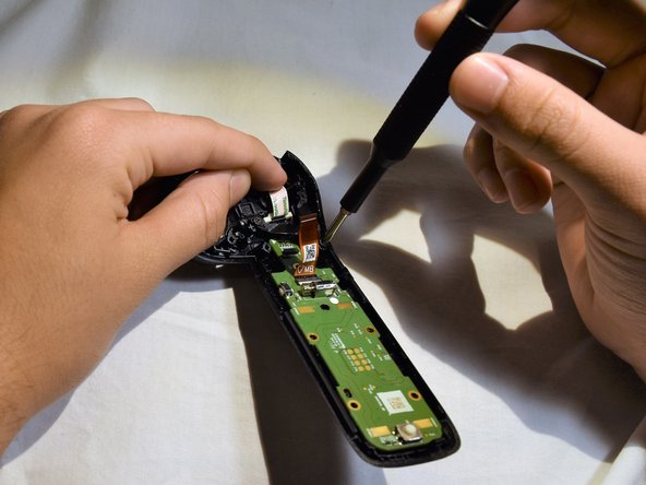

  5. HP Windows Mixed Reality Controllers TPC-Q044 Touch Pad   Replacement, Small Circuit Board: crwdns2935265:05crwdnd2935265:01crwdnd2935265:02crwdne2935265:0 HP Windows Mixed Reality Controllers TPC-Q044 Touch Pad   Replacement, Small Circuit Board: crwdns2935265:05crwdnd2935265:02crwdnd2935265:02crwdne2935265:0
    • Using a Phillips #00 screwdriver, remove the four 4mm screws located on the joystick circuit board underneath the top half of the controller.

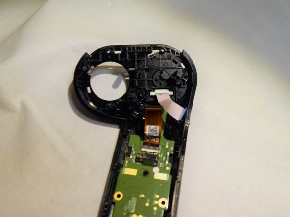

  6. HP Windows Mixed Reality Controllers TPC-Q044 Touch Pad   Replacement: crwdns2935265:06crwdnd2935265:01crwdnd2935265:03crwdne2935265:0 HP Windows Mixed Reality Controllers TPC-Q044 Touch Pad   Replacement: crwdns2935265:06crwdnd2935265:02crwdnd2935265:03crwdne2935265:0 HP Windows Mixed Reality Controllers TPC-Q044 Touch Pad   Replacement: crwdns2935265:06crwdnd2935265:03crwdnd2935265:03crwdne2935265:0
    • Remove the orange flat cable by pulling the orange tab parallel to the circuit board.
    • Release the blue flat cable by lifting up the white latch with a spudger.

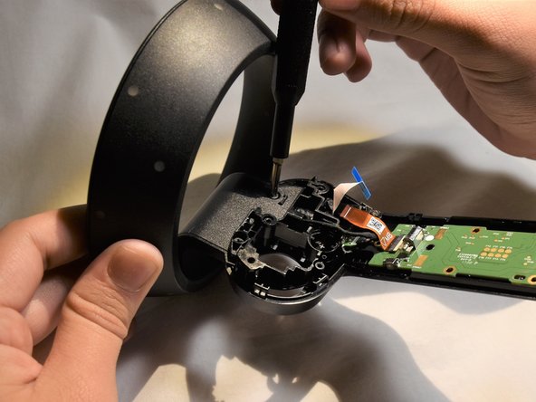

  8. HP Windows Mixed Reality Controllers TPC-Q044 Touch Pad   Replacement: crwdns2935265:08crwdnd2935265:01crwdnd2935265:03crwdne2935265:0 HP Windows Mixed Reality Controllers TPC-Q044 Touch Pad   Replacement: crwdns2935265:08crwdnd2935265:02crwdnd2935265:03crwdne2935265:0 HP Windows Mixed Reality Controllers TPC-Q044 Touch Pad   Replacement: crwdns2935265:08crwdnd2935265:03crwdnd2935265:03crwdne2935265:0
    • Remove the two 3mm screws on the V-clip using a Phillips #00 screwdriver.
    • Remove the V-clip from the device.

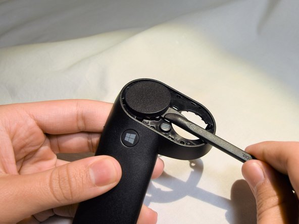

  9. HP Windows Mixed Reality Controllers TPC-Q044 Touch Pad   Replacement: crwdns2935265:09crwdnd2935265:01crwdnd2935265:03crwdne2935265:0 HP Windows Mixed Reality Controllers TPC-Q044 Touch Pad   Replacement: crwdns2935265:09crwdnd2935265:02crwdnd2935265:03crwdne2935265:0 HP Windows Mixed Reality Controllers TPC-Q044 Touch Pad   Replacement: crwdns2935265:09crwdnd2935265:03crwdnd2935265:03crwdne2935265:0
    • Unclip one of the tabs on the underside of the touch pad.
    • Using a spudger, pop off the touch pad.
