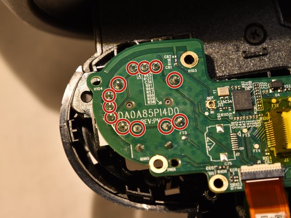

  7. HP Windows Mixed Reality Controllers TPC-Q044 Joystick Switch Replacement, Joystick Switch: crwdns2935265:07crwdnd2935265:01crwdnd2935265:02crwdne2935265:0 HP Windows Mixed Reality Controllers TPC-Q044 Joystick Switch Replacement, Joystick Switch: crwdns2935265:07crwdnd2935265:02crwdnd2935265:02crwdne2935265:0
    • The joystick controller is soldered directly to the circuit board. You can find instructions for removing soldered components here.
    • The joystick controller is secured by 12 solder connections. Once these have been desoldered, the controller can be removed.

You can solder replacement Xbox One analog sticks right? I have some stick drift and can’t test this until my university reopens, but when it does I want to try fixing it.
Edit: I have the Dell controllers but they seem identical to the HP ones in this guide.
Vincent - crwdns2934203:0crwdne2934203:0
I think this might be the stick: https://www.mouser.com/ProductDetail/Alp...
Alps RKJXV 23 degree 10K ohm multi-directional switches
I haven’t soldered it yet so do not take my word as fact, it just looks right.
