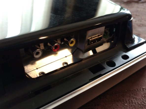

  6. HP TouchSmart 600 Cooling Fan Replacement, Removing Input panels: crwdns2935265:06crwdnd2935265:01crwdnd2935265:02crwdne2935265:0 HP TouchSmart 600 Cooling Fan Replacement, Removing Input panels: crwdns2935265:06crwdnd2935265:02crwdnd2935265:02crwdne2935265:0
    • There are two side panels that need to be removed. The one on the top left side (HMDI) is simply a snap on panel. You have to carefully pry it away from the side.
    • The other side is the network, usb and TV input panel. You don't need to remove this one at first but it eventually makes it easier if its off. Just carefully pry it away once the screws have been removed.

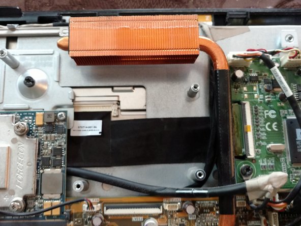

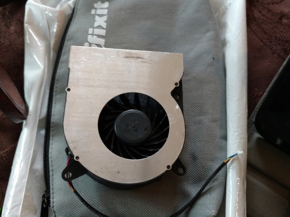

  9. HP TouchSmart 600 Cooling Fan Replacement, Fans exposed: crwdns2935265:09crwdnd2935265:01crwdnd2935265:03crwdne2935265:0 HP TouchSmart 600 Cooling Fan Replacement, Fans exposed: crwdns2935265:09crwdnd2935265:02crwdnd2935265:03crwdne2935265:0 HP TouchSmart 600 Cooling Fan Replacement, Fans exposed: crwdns2935265:09crwdnd2935265:03crwdnd2935265:03crwdne2935265:0
    • The two fans on the Motherboard are identical, one is face up and the other face down.
    • Remove the four screws holding the fan down and unplug the unit from the motherboard.
    • You will need to peel the tap off the copper heat sink at the top and you may need to lift up on the heat sink to get the fan body to clear.
    • Lift up and then remove the fan.

Just got the “fan dead, powering down” message on screen, so I’m just starting the process.
2 questions: 1-without power, how do I know which of the 2 fans is dead, or do I just replace them both? 2-Where did you get your replacement fans?
Thanx Much
Bob Chaphe
bobchaphe@gmail.com
BOB CHAPHE - crwdns2934203:0crwdne2934203:0
Hi Bob I purchased my fans on ebay and I ended up replacing both. I would imagine that once the computer has cooled down you should be able to power it back up for a quick few seconds to get to the BIOS and or (with the back cover off) see which fan is dead. Probably just best to replace both based upon the age of the computer at this point.
