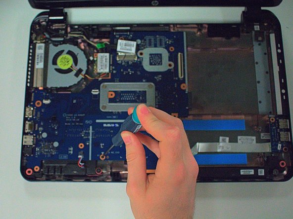

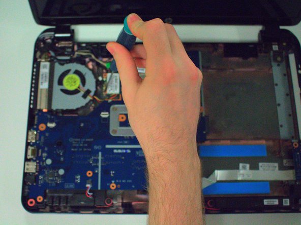

    • There are 3 screws holding the motherboard in place.
    • Unscrew the screws to release the motherboard.
  15. HP TouchSmart 15-r015dx RAM Replacement: crwdns2935265:015crwdnd2935265:01crwdnd2935265:03crwdne2935265:0 HP TouchSmart 15-r015dx RAM Replacement: crwdns2935265:015crwdnd2935265:02crwdnd2935265:03crwdne2935265:0 HP TouchSmart 15-r015dx RAM Replacement: crwdns2935265:015crwdnd2935265:03crwdnd2935265:03crwdne2935265:0
    • There are several wires that need to be disconnected from the motherboard.
    • Remove the wires carefully.
  16. HP TouchSmart 15-r015dx RAM Replacement: crwdns2935265:016crwdnd2935265:01crwdnd2935265:01crwdne2935265:0
    • After removing all the wires, pull the motherboard out.

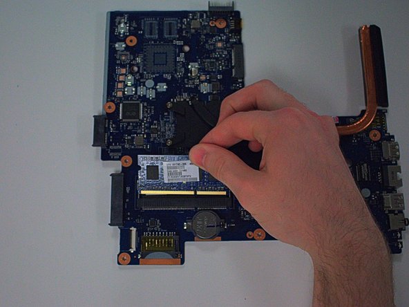

  17. HP TouchSmart 15-r015dx RAM Replacement, RAM: crwdns2935265:017crwdnd2935265:01crwdnd2935265:01crwdne2935265:0
    • Put the motherboard on a hard, flat surface to avoid damaging it.
    • The RAM is marked in red.
  18. HP TouchSmart 15-r015dx RAM Replacement: crwdns2935265:018crwdnd2935265:01crwdnd2935265:02crwdne2935265:0 HP TouchSmart 15-r015dx RAM Replacement: crwdns2935265:018crwdnd2935265:02crwdnd2935265:02crwdne2935265:0
    • There are two switches holding the RAM in place that need to be moved.
    • After the switches are released, simply pull the RAM up as shown.

Cool, thanks guys. I used the guide successfully to upgrade the RAM on my HP 15-r033na Notebook. It would have taken ages without your help! A really tough way to reach the memory.
I wonder if the second DIMM slot is usable. The specs I've found says this board only takes one card, so maybe the second is disconnected.
