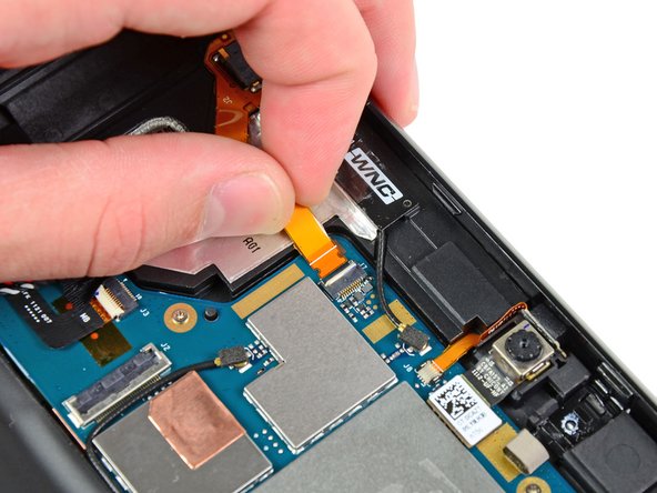

  11. HP TouchPad Upper Antenna Replacement, Upper Antenna: crwdns2935265:011crwdnd2935265:01crwdnd2935265:02crwdne2935265:0 HP TouchPad Upper Antenna Replacement, Upper Antenna: crwdns2935265:011crwdnd2935265:02crwdnd2935265:02crwdne2935265:0
    • Use the edge of a plastic opening tool to flip up the retaining flap on the headphone jack ribbon cable ZIF socket.
    • Pull the headphone jack ribbon cable out of its socket and bend the cable away from the large piece of EMI foil stuck to the top speaker.
  12. HP TouchPad Upper Antenna Replacement: crwdns2935265:012crwdnd2935265:01crwdnd2935265:01crwdne2935265:0
    • Use a plastic opening tool to pry the upper antenna connector up from its socket on the motherboard.
  13. HP TouchPad Upper Antenna Replacement: crwdns2935265:013crwdnd2935265:01crwdnd2935265:01crwdne2935265:0
    • Use a plastic opening tool to peel the upper antenna off the adhesive securing it to the top speaker.
  14. HP TouchPad Upper Antenna Replacement: crwdns2935265:014crwdnd2935265:01crwdnd2935265:01crwdne2935265:0
    • Carefully peel the foil tape attached to the upper antenna off the top speaker.
    • Remove the upper antenna from the TouchPad.
