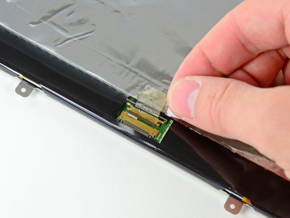

  13. HP TouchPad LCD Replacement, LCD: crwdns2935265:013crwdnd2935265:01crwdnd2935265:01crwdne2935265:0
    • Use the edge of a plastic opening tool to peel up the self-adhesive pull tab stuck to the display data cable.
  14. HP TouchPad LCD Replacement: crwdns2935265:014crwdnd2935265:01crwdnd2935265:02crwdne2935265:0 HP TouchPad LCD Replacement: crwdns2935265:014crwdnd2935265:02crwdnd2935265:02crwdne2935265:0
    • Pull the tab up and toward the middle of the display to unlock the display data cable connector from its socket on the LCD.
    • Pull the display data cable out of its socket on the LCD and set it aside.
    • Do not lift upward on the connector as you pull it out of its socket. Pull the connector parallel to the face of the LCD.
