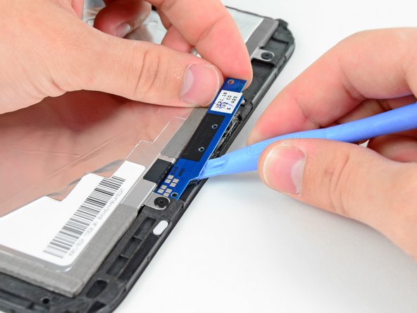

  11. HP TouchPad Home Button Board Replacement, Home Button Board: crwdns2935265:011crwdnd2935265:01crwdnd2935265:02crwdne2935265:0 HP TouchPad Home Button Board Replacement, Home Button Board: crwdns2935265:011crwdnd2935265:02crwdnd2935265:02crwdne2935265:0
    • Use a plastic opening tool to pry the home button board off the adhesive securing it to the front panel.
    • Be careful not to flex the board too much. It is very thin and delicate.
  12. HP TouchPad Home Button Board Replacement: crwdns2935265:012crwdnd2935265:01crwdnd2935265:01crwdne2935265:0
    • Remove the home button board from the front panel.
