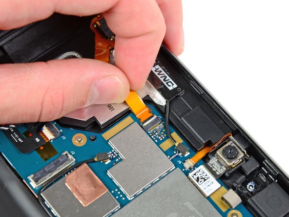

  10. HP TouchPad Headphone Jack Replacement: crwdns2935265:010crwdnd2935265:01crwdnd2935265:01crwdne2935265:0
    • Remove the front panel assembly from the rear case assembly.
  11. HP TouchPad Headphone Jack Replacement, Headphone Jack: crwdns2935265:011crwdnd2935265:01crwdnd2935265:02crwdne2935265:0 HP TouchPad Headphone Jack Replacement, Headphone Jack: crwdns2935265:011crwdnd2935265:02crwdnd2935265:02crwdne2935265:0
    • Use the edge of a plastic opening tool to flip up the retaining flap on the headphone jack ribbon cable ZIF socket.
    • Pull the headphone jack ribbon cable out of its socket.

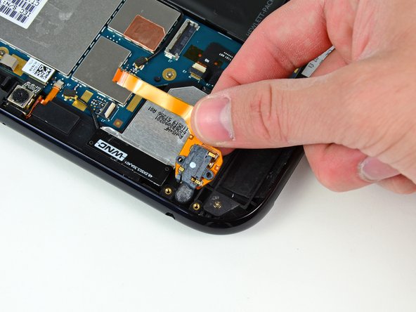

  12. HP TouchPad Headphone Jack Replacement: crwdns2935265:012crwdnd2935265:01crwdnd2935265:01crwdne2935265:0
    • Remove the two 4.4 mm Phillips screws securing the heaphone jack to the rear case.
  13. HP TouchPad Headphone Jack Replacement: crwdns2935265:013crwdnd2935265:01crwdnd2935265:02crwdne2935265:0 HP TouchPad Headphone Jack Replacement: crwdns2935265:013crwdnd2935265:02crwdnd2935265:02crwdne2935265:0
    • Use a plastic opening tool to pry the headphone jack away from the adhesive securing it to the rear case.
    • Remove the headphone jack.
