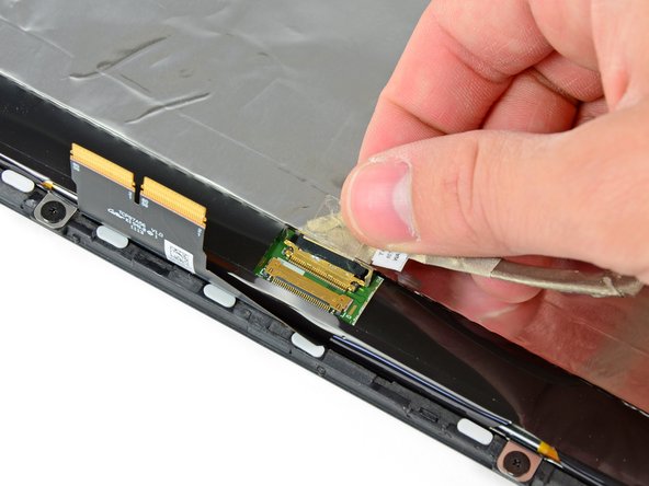

    1. HP TouchPad Display Data Cable Replacement, Display Data Cable: crwdns2935265:011crwdnd2935265:01crwdnd2935265:01crwdne2935265:0
      • Use the edge of a plastic opening tool to peel up the self-adhesive pull tab stuck to the display data cable.
    2. HP TouchPad Display Data Cable Replacement: crwdns2935265:012crwdnd2935265:01crwdnd2935265:02crwdne2935265:0 HP TouchPad Display Data Cable Replacement: crwdns2935265:012crwdnd2935265:02crwdnd2935265:02crwdne2935265:0
      • Pull the tab up and toward the middle of the display to unlock the display data cable connector from its socket on the LCD.
      • Pull the display data cable out of its socket on the LCD and set it aside.
      • Do not lift upward on the connector as you pull it out of its socket. Pull the connector parallel to the face of the LCD.
